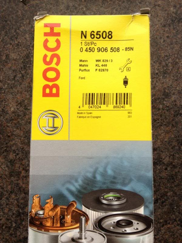

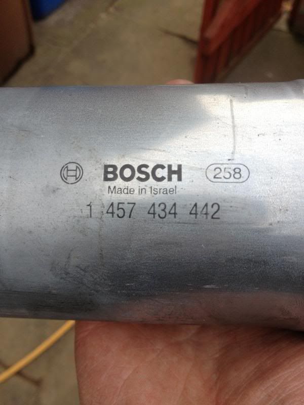

Fuel filter - Bosch 0 450 906 508 my old Bosch filter has part number 1 457 434 442 and is slightly different.

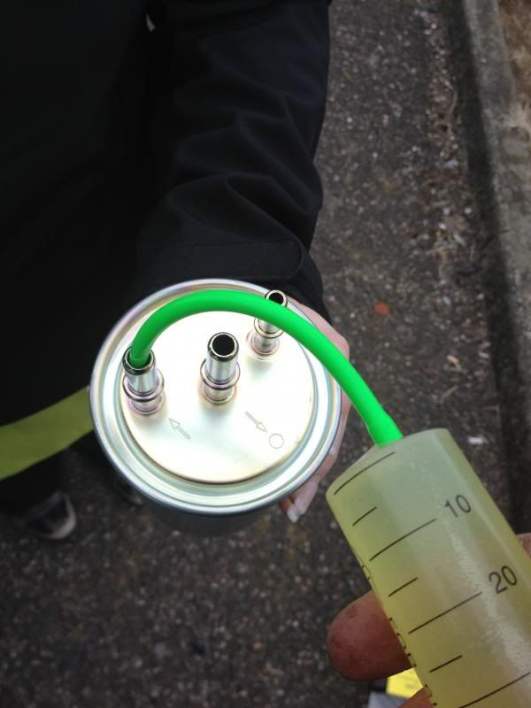

A large syringe. I used a 60ml syringe.
Fresh diesel

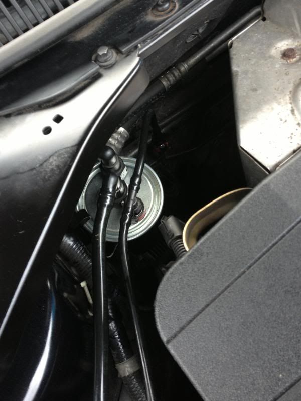

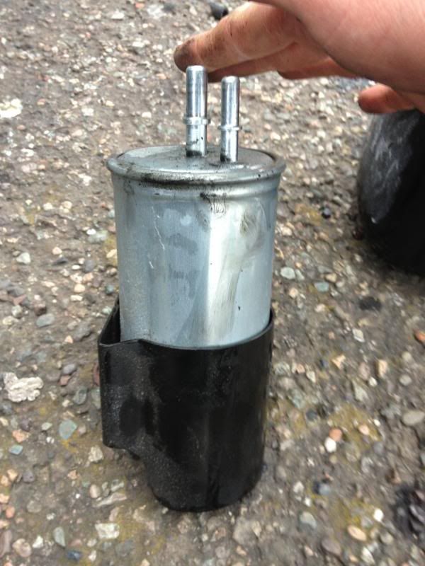

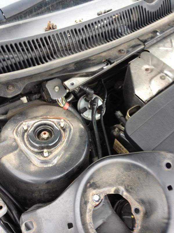

This can be done with only a few rags and a syringe or if you wish to have extra room to work you will need an 8mm socket and a 13mm (deep preferably) socket and ratchet.
In my guide I have removed the metal brace for clarity and to show how its done if you so wish to do it this way.
So you will need a new fuel filter, I bought a Bosch filter as they make the original and at less than half the Ford price it's a no brainer. A Bosch filter can be had for around £20 including postage.
I change my fuel filter every 12-18 months, covering approx 20k miles a year.
Lets have a look at the filter: (note the arrows and port sizes)

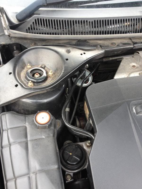

Next you will need to open the bonnet and look at the rear of the engine on the left hand side, you should see the filter hiding down there.
Remove the 7 nuts/bolts holding the metal brace and remove it completely (5x 13mm head nuts and bolts, 2x 8mm bolts) And you should be left with this
For the next stage it is advisable to cover the alternator with some rags as there will be some spillage and it WILL drop onto the alternator.
The clips holding the fuel pipes onto the filter now need to be released, simply push the 2 locking clips using 2 fingers (no need for any tools - they are very simply to release) and push the clip forward. once its unlocked pull the clip out as far as it will come. Do this for all 3 pipes then pull the pipes off and move them slightly so they are not in the way of the filter coming out, you will have some diesel leaking out now.
Now that the pipes are disconnected, pull the filter upwards, noting that the filter is housed in a metal bracket which slides onto 3 plastic clips.You might find the filter comes out without the metal housing, even better if it does.
You should be left with this: (I have started removing the filter from the metal housing)
Remove the old filter from the bracket and discard of it safely - mind it is full of fuel.
Now have your missus stand holding the filter while you fill/prime it with diesel. Remember to fill it on the inlet port as you don't want any dirt getting to the injectors! Once the filter is full (took about 400ml IIRC) you might see the level drop down again - don't worry about this yet, its just the paper element soaking in the diesel.
Once the filter is full, refit it to the metal bracket and then slide the assembly back into the car making sure it catches all 3 clips - this can be tricky.
Once its back in and secure, you can top up with diesel if required and fit all 3 pipes again - noting that the smaller port goes to the front. the pipes simply slide back on and when fully home just push the clip back in to lock it. Remove your rags from the alternator and clean up any mess.
Refit the metal brace then stand back and look at your shiny new filter:

Here is a pic of the old filter part number:

Tuning Boxes, My Experience And Fitting Them
Posted jdsheff on 06 May 2015 - 02:40 PM in General Ford Guides - Modern Fords
I always come onto this forum asking for advice but never putting any input on this forum and to help others. Now its my turn! Im here to help and give limited advice on my findings regarding tuning boxes with today's technology and how to fit them.
Please bear with me regarding this long post. This is for the haters, the doubters and weather a tuning box is for you.
Picture heavy
Since buying my MK2 Ford Focus TDCI 115BHP (November 2014) it was just a 'ok' drive but wasn't what I wanted. So I was regretting buying this vehicle because it lacked everything in the drivability and performance. Also setting off on the roundabouts, I hated it!
Firstly what was mentioned is to blank the EGR off with a £3 stainless steel plate. Once I did that, my word was the car picking up alot better. I thought the drivability was much better and I didn't dread going into a roundabout without cutting someone up!
This is my daily driver so I wasnt going to start upgrading the hell out of it. A baby on the way and a 20,000 mile annual commute makes me needing to keep this reliable.
Now although the car does have some pull, this still seriously lacked performance. So I looked into remaps, custom remaps and tuning boxes. They all varied from £89-£500.
Iv had all of them during my driving life and varied in quality.
Now I know a remap maybe much better for what I wanted (iv had petrol turbo previously) but I also had a tuning box before. This was on a Volkwagon PD engine.
The car in question was a VW Bora 1.9TDI (115bhp). The tuning box pushed up the bhp to around 135bhp.
Once chipped these go like a rocket BUT it produced a massive smoke screen! My other 'remapped' Magane smoked aswell even tho it went back 3 times for different things regarding the custom map, but still produced smoke with good power gains.
Now roll on 10 years from my first tuning box to todays technology. Full of microchips, processors and other things I not had before.
I started looking into these boxes as I want to remove it if/when warranty work was needed, the fact its a daily family car so I wasn't going to spend the earth on £100 per 10bhp horses.
Loads of places claim this, claim that and too many to choose from. Only 1 stood out from hours and hours of constant reading reviews and people's extensive experience.
The Synergy 2b 2 channel box from tuning diesels. http://www.tuning-di...ergy-ronbox-2b/
Alot of praise seems to go their way regarding what has been achieved and reliability over the years of the production. Also made in Britain is a big plus!
When reading more into it you can infact alter the settings to your satisfaction which is more of interest aswell since you cant do this with a remap.
The other side of things, it also connects to the map sensor to alter boost (4-5psi the most on maximum setting) from the turbo. It does make sense as when the fuel is there, you can infact up the boost to match which creates more performance. More boost without fuel just decreases the power and has a reverse effect. This is the good thing with diesel engines as from a petrol which needs the correct air/fuel ratio. A 1 channel tuning box seems to run out of puff after 3000rpm aswell in my experience.
I had spoken to the owner 'Ron' about all my needs, questions, requirements and he couldn't of been more helpful knowing the knowledge he has. No sales team, no fancy overheads and no advertising to pay for. Just the Chap who created these. You just need to visit the website to notice this lol.
Now he has created a button/switch which plugs directly into the box and can select 3 options. Eco, power or off which are illuminated with different colours to which you have selected. No other wiring is needed and the box creates its little signal/voltage to power this button. You can't do that with a remap either. When time and alittle more money comes my way, il give this a shot.
I ignored all the crap you get with 'danger to fuel pump, danger to injectors' lark. You bring me concrete evidence and il shut up....
Iv had a tuning box before and didnt kill the engine after 113,000 miles before I sold her. That was with a nitrous oxide kit fitted aswell (wizards of Nos) on original clutch, injectors, pump etc aswell. So in my book, what aload of crap from scare mongers!!!

Next was the map sensor side of things.
Locate this first.
This is the sensor located on top of the engine block just beside the oil filler cap as pictured.
Theirs alittle clip you push to make the the connection release.
Once off, its good to see the exact same oem connectors are used.
I plugged one end into the original connectors and the tuning box end going into the map sensor itself.
Now Ron includes cable ties but I found these alittle too small to work with and fiddly. So I went to the hardware shop (next door to work) and got bigger ones.
I then followed the cabling going to the rear of the engine and across to the map sensor.
So tied up in 2 places on the fuel rail side of things.
Then tied up 2 places on the map sensor side of things.
Everything looks nice and tidy.
