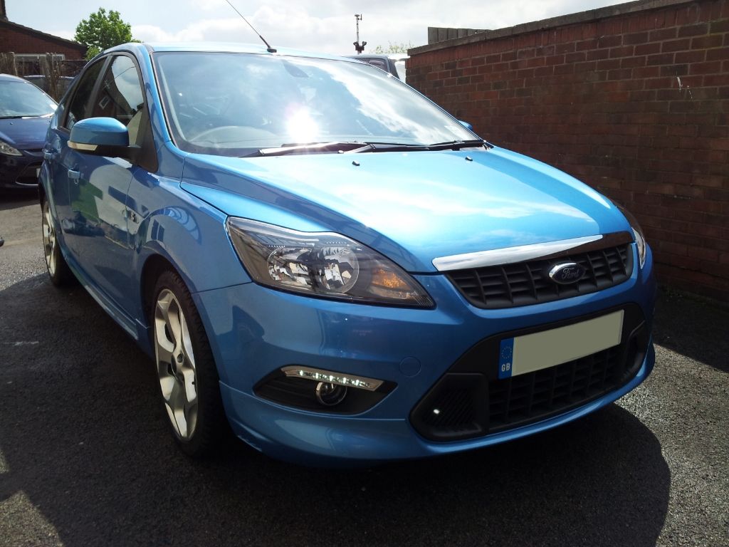

Cheers for the great guide preee , got mine fitted today . Not received my piggyback fuse yet so its not properly wired up to the acc yet .
Preee
May 19, 2013, 6:10 am
Looks great Nick , loving the colour of your car m8
Nickster
May 19, 2013, 6:51 am
Cheers Paul , sometimes wish i'd gone for silver after seeing how good yours looks ! and vision blue is a swine to paint match as i'm just finding out ... stupidly scratched the rear wheel arch right down to metal couple of weeks back :(
