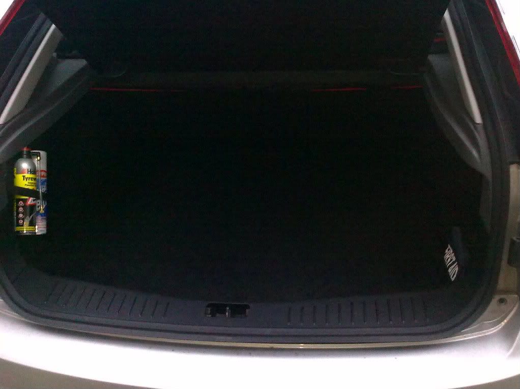

[size=4][b]The biggest wheel you will fit is a 16'' with a 205/55/R16 mate,
but it would be usless to you since the car has 18's all around,
i carry a full sized spare with the floor lifted kit, the same carpet fits in place but the boot floor in now flush woth the opening sill,
and it weighs the car down carrying it around.
[img]http://i575.photobucket.com/albums/ss192/lennymanwoods/Image0995.jpg[/img]
[img]http://i575.photobucket.com/albums/ss192/lennymanwoods/Image0994.jpg[/img]
[img]http://i575.photobucket.com/albums/ss192/lennymanwoods/Image0998.jpg[/img]
the focus st has the 18'' wheels as standard and doesnt use a spare tyre at all,
instead it carrys the compressor and foam, thats why ford have fitted a 12v power supply in the boot of the car for models with 17'' wheels and higher to use the compressor kit.
here is a link to one and their is a foam pad to hold the compressor in the tyre well.
[url="http://www.ebay.co.uk/itm/FORD-AIR-COMPRESSOR-TYRE-INFLATOR-/300744426807?pt=UK_CarsParts_Vehicles_CarParts_SM&hash=item4605c3c537"]http://www.ebay.co.u...=item4605c3c537[/url]
they also have a light on the side of them to illuminate the wheel and the internal cable reaches around 15 feet.[/b][/size]
[size=4][b]Take it from the Sherpa [/b][/size]
[size=4][b]buy yourself a compressor kit and forget about the space saver. [/b][/size]
[size=4][b]choice is yours regarding carrying the jack and wheel brace though, no need when you have the compressor. [/b][/size]

In the original post, the question was asked : would the 18" rim fit in the boot.
So I've had a look at my space saver, and done a comparison.
1) My space saver : 125 / 85 R 16. - Total diameter 619 mm
2) My standard tyre : 205 / 55 R 16. - Total diameter 632 mm
3) Your wheel : 225 / 40 R 18. - Total diameter 637 mm
(All calculations courtesy of [url="http://www.tyresizecalculator.com/"]http://www.tyresizecalculator.com/[/url])
The biggest size difference is between my own space saver and my own standard wheel/tyre - and that's 13mm
I haven't tried my own standard alloy in the boot, but I assume that it fits OK because Lenny has a full size spare with no complaints.
The difference between my own standard wheel/tyre and the 18" belonging to the gc88 is just 5mm.
Therefore I think it's safe to say that the 18" will fit.
Makes sense really, because if Ford make sure that the total rolling radius of the all tyres they fit to the various Focus models is the same (whatever the rim size / side profile) then they don't have to recalibrate the speedo for different cars.
