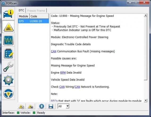

I have been having a few issues with my new (to me) 2008 Focus 1.8
have had the following error code come up several times
Could anyone tell me what could be causing it?
FOCA
Apart from the codes what is the problem?
Is the speedo and rev counter working ok?
jeebowhite
Sounds like a bad crank sensor?
CrankyApe
I have been having issues with the car coughing and stalling now this error.
Get a jolt while I idelling
troy45
Car would run poorly if it's not getting the usual signals from the crank sensor - you could try the dash test mode to look at the rpm figures more accurately and see if they're steady or jumping around all over the place?
CrankyApe
I'll try that tomorrow
