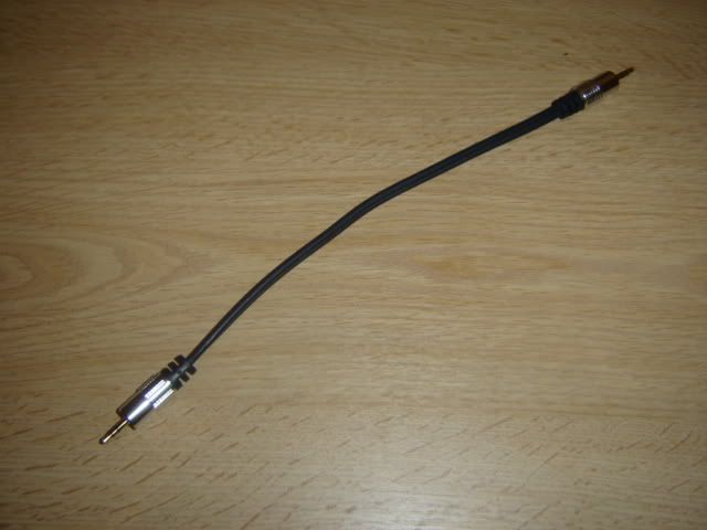

You will have a single Line in/AUX port just in front of the gear stick. This port takes a 3.5mm jack (commonly referred to as a headphone jack) such as this:
To connect an MP3 player or iPod to this port, you will need a 3.5mm jack - to 3.5mm jack lead such as this:
Connect one end to the Line in/AUX port in the car and the other the headphones output (or you can use Line Out if the player has one) of the MP3 player
The MP3 player/iPod will be controlled in the same way as if you were listening to it through headphones - as you've essentially turned your Fiesta into a giant pair of headphones.
Importantly - the MP3 player/iPod will not charge and no track information will be displayed on the car's screen. Also, you cannot use the stereo/steering wheel controls to skip tracks. The volume controls will work, but this is only controlling the volume of the stereo itself. I suggest you set the volume of the MP3 player iPod at 50% and then crank up the car's volume - the battery life of the MP3 player/iPod will be better than if you have it set at 100% all the time and distortion is a possibility if you have it so high.

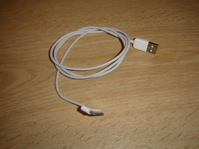

So here is my alternative:
After reading JAR's thread, I was intrigued as to how Ford had managed to get only their cable to work - simple fact, they haven't. I have tested official Apple cables, Kensington Cables, Cambridge Audio cables and they all work fine.
I currently use an official Apple branded dock connector jack - USB jack cable and an unbranded 3.5mm jack - 3.5mm jack cable (for no other reason than they're both quite long).
The dock connector connects to the bottom of the iPod (I use a 5G Video 30gig iPod) and the USB jack at the other end plugs into the car's USB port. The 3.5mm jacks at either end of the other lead plug into the car's Line in/AUX port and the headphone socket of the iPod.
You MUST use both leads of you want data to be displayed on the car's screen and to have full control through the stereo and steering wheel.
I have run the leads under the driver's seat and then velcro'd the iPod to the underside of the driver's seat. It's very neat, the iPod is always ready (yet out of sight of thieves) and the handbrake is unimpeded.
