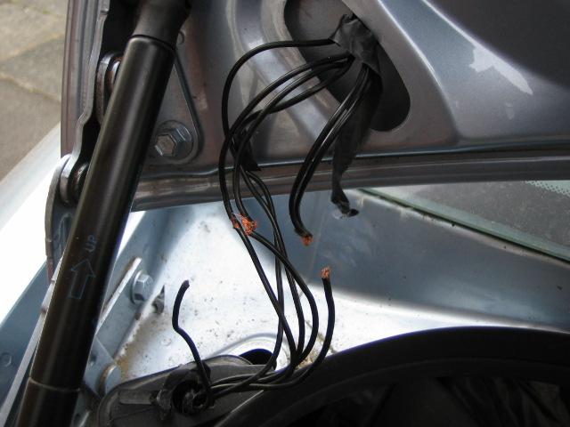

I have got a 06 focus saloon I could not open my boot, some times it would open then it would not, I took the lock apart lock was ok
if I closed the boot half way it would work if I shut boot fully it would not work also the boot light stopped working, so I started looking at the wiring
and found where the wiring goes from the boot lid to the boot through the (rubber boot) the wiring was broken and frayed
I have now sorted the wiring out and all is working fine now
Hope this helps some one out
