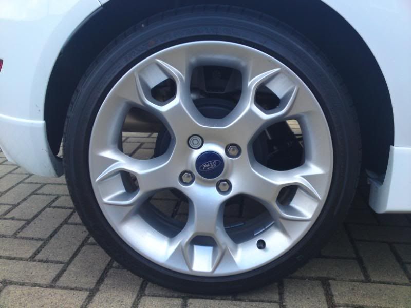

Focus_ST-3 Posted March 31, 2010 Share Posted March 31, 2010 Does anybody know the offset of the Street/X Pack 17" alloys? If I were to buy a new set of 18" alloys, would the offset have to be the same as the wheels currently on the car? Thanks Quote Link to comment Share on other sites More sharing options...
rocky1722 Posted March 31, 2010 Share Posted March 31, 2010 These wheels are 7x17 ET 47.5 I fancy fitting 18's at some point also. Ashman has 18's fitted and I think he has no problems with rubbing etc. Can't remember if he posts on her or ZSOC. Quote Link to comment Share on other sites More sharing options...

ASHMAN Posted April 1, 2010 Share Posted April 1, 2010 These wheels are 7x17 ET 47.5 I fancy fitting 18's at some point also. Ashman has 18's fitted and I think he has no problems with rubbing etc. Can't remember if he posts on her or ZSOC. My alloys are 18" and offset is 45. 215/35/18 xl tyres. Fit perfect,lowered too.no problems at all. Quote Link to comment Share on other sites More sharing options...
