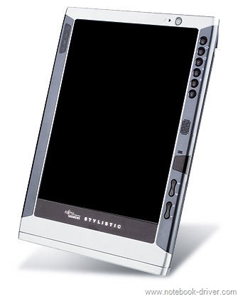

i have a fujitsu tablet pc that should fit nicely behind the glove box and has enough processing power to run centrafuse.

for me as i have all the kit gathering dust ill probably only spend about £100 - £150 thats for screen and elm327. the tablet pc i traded my old crapy computer at the computer repair shop i used to work at :D

space wise the tablet pc will be behind the glove box and well hidden out of sight.
