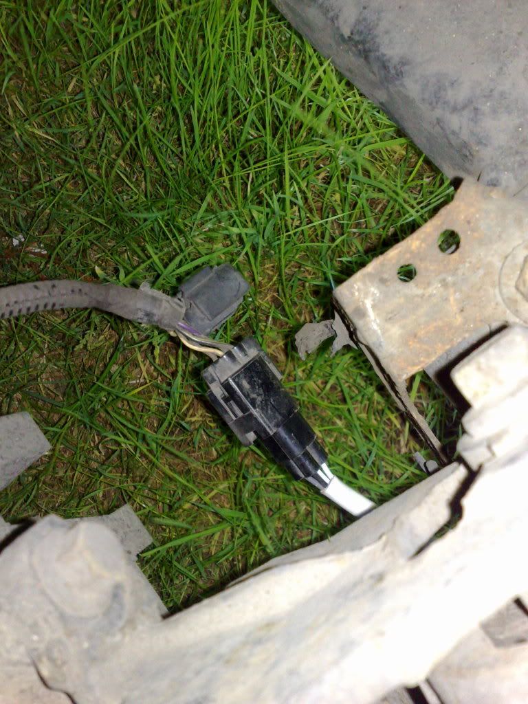

Sorry about the late reply, i haven't found any1 who will do a reading cheaper than £95! today i had some time so read about the forums for inspiration, there were a few things i tried that haven't had any effect however i did notice there is a wire with a plug on the end that isn't plugged onto anything. See the images below. The white wire connects to the Cat which the last owner had replaced and is still under warranty but the where the black where connects to the white cable there is another plug, is this meant to be connected to something? Ive checked all around the area for somewhere for it to connect to and cant find any which makes me think either A) something has fallen out or
its for a higher model and irrelevant to my model. Please help!

why do manufactors use the same looms for various cars just confuses the hell out of things, to me it looks like an aux plug for a higher grade of model.i dont think you will win by just trying different things on your car sometimes you just have to admit defeat and book it in, with all the sensors nowadays you could go on for weeks !
