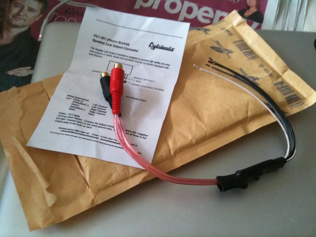

The RCA converter came this morning
Will it be obvious as to where the 'earth' is on my stereo unit (assuming it is on the unit itself)

i have installed subwoofers into my fiesta and all i did was run it off the back speakers.i alsohave 6x9's in so i bridged the 2 amps i have for power source and earth and then ran speakers off one and then sub off the other. i ran wires from both left and right rear speakers and then into the RCA converter. then put the earth to a bolt in the boot. the RCA converter then plugs into your amplifier and so on.. thinking about the tints myself tho.. looks sweetJamie
Thanks about the tints! :D
but maybe i should have been more clear when talking about my install.
I am planning to use the rca converter off the back of the 'head unit' like has been done in this thread
Basically adding the speaker connections of the rca converter, pictured above, to the multi-block. But there is also an earth cable on the rca converter.. i dont know where this goes to (unless it there is an earth on the multi-block?) This is what i would like to know?
And so have you basically got extra wires coming off the +ve and -ve terminals of your rear speakers and into the rca converter which is located near to your sub and amp?
And then you have a really short length of rca cable from the converter to the amp?

Any help with the earth for the rca converter would be greatly appreciated tho

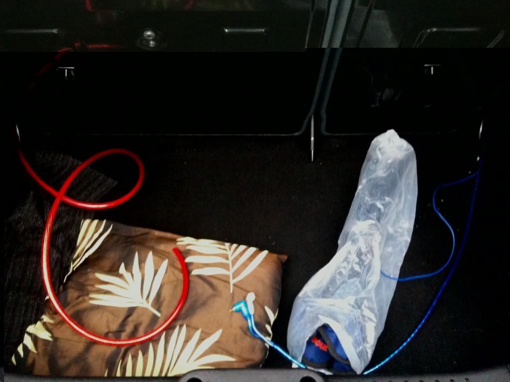

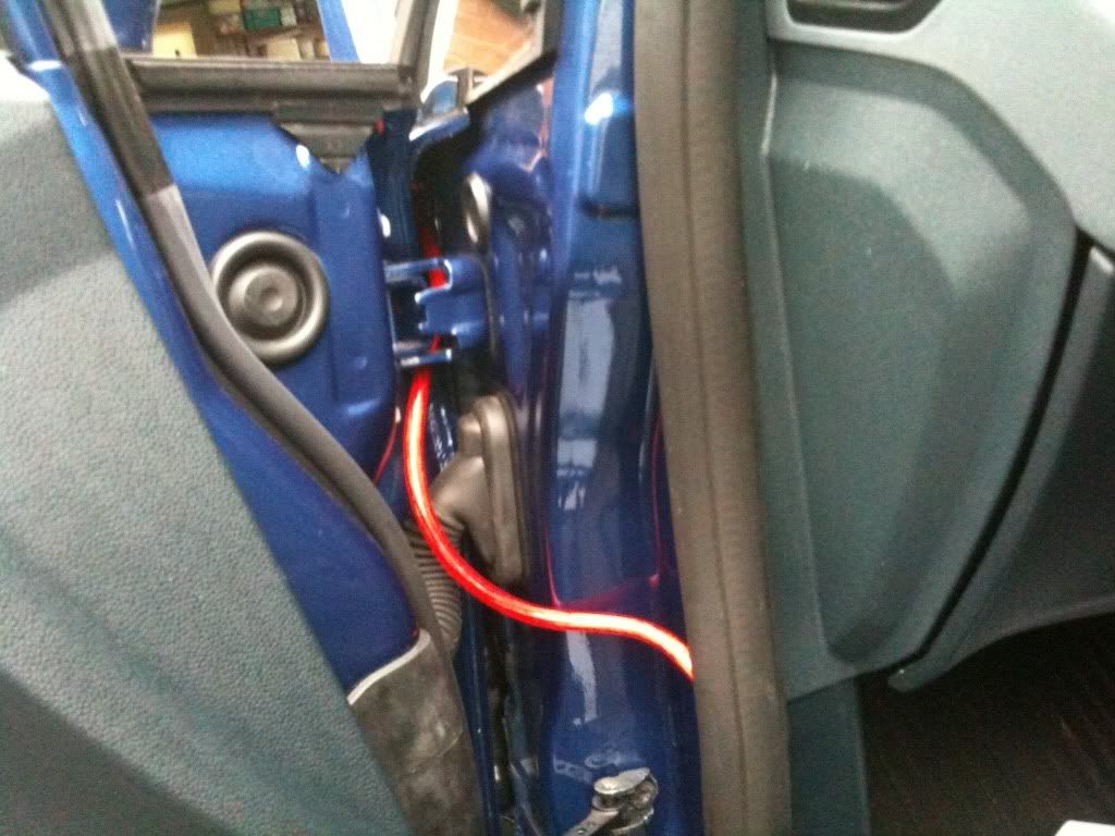

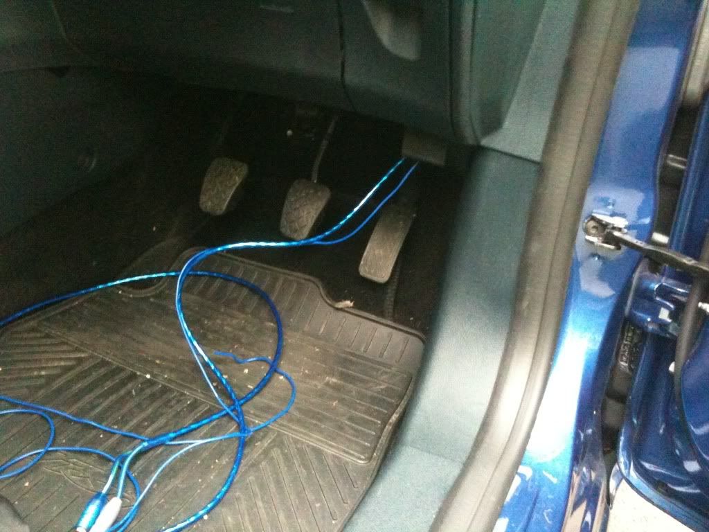

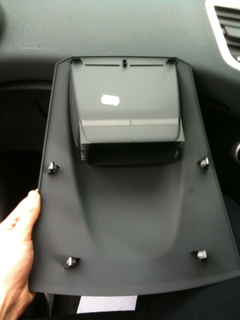

So... gave the wiring a couple of hours of my time today.. to start with i couldnt get the head unit out (was too scared about breaking something as there was waaay too much resistance on the 4 clips which hold the top cover on)
But managed to feed the power cable from the battery to the boot and the rca and remote from the boot to the drivers footwell

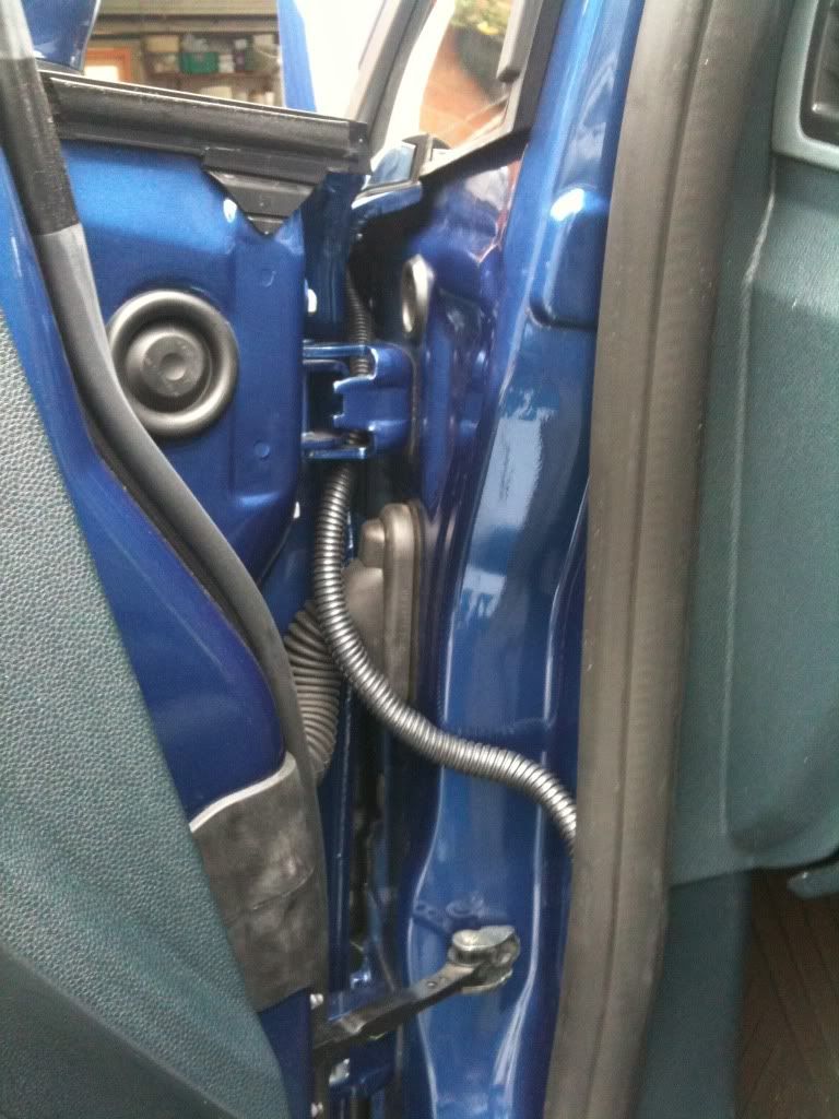

The power lead is obvious in the door shut however once wrapped with some black sheathing it should look fine.

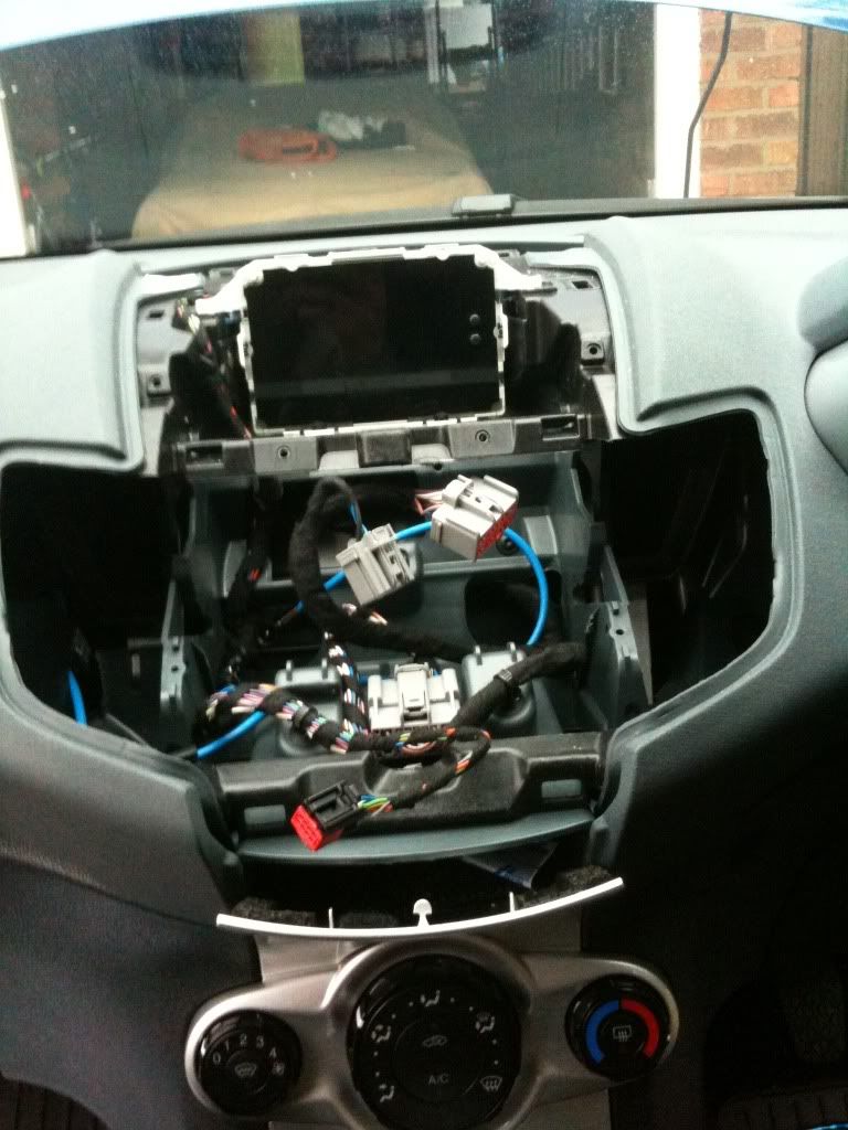

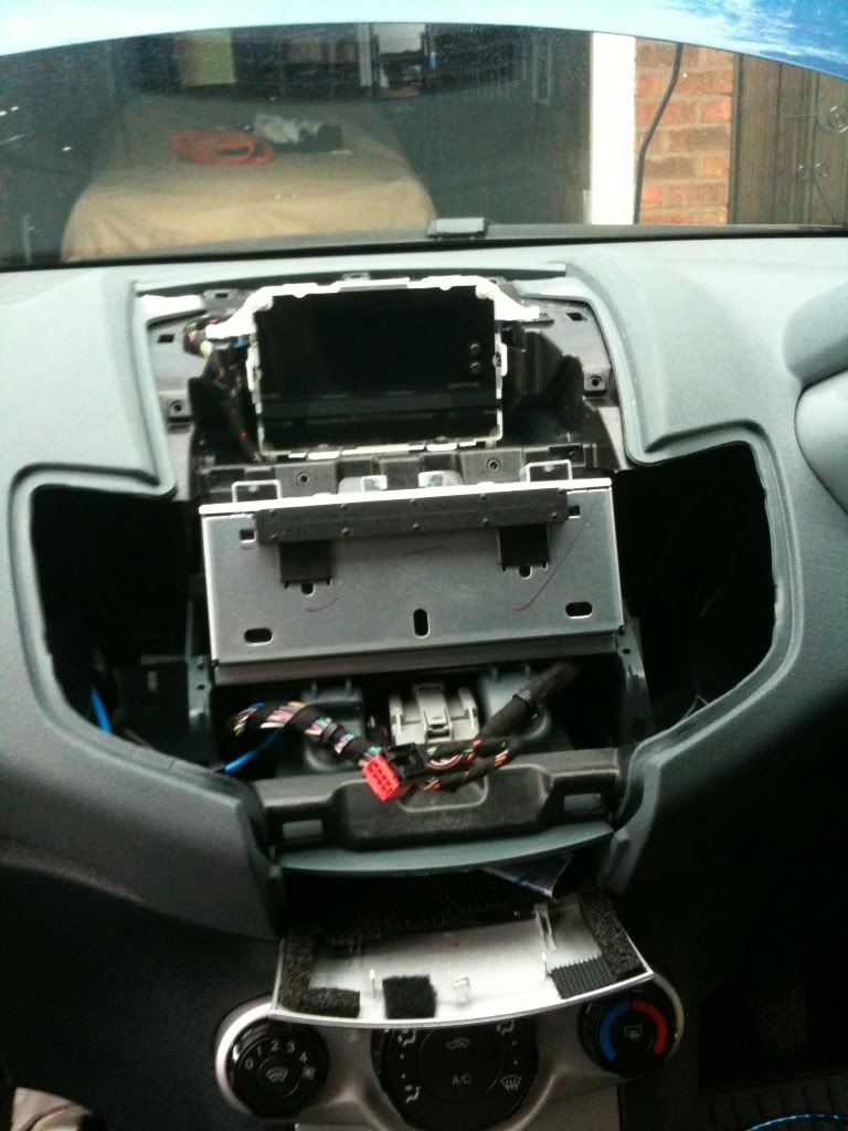

I then decided to persist with the top cover, and, after hurting the ends of my fingers loads, i managed to pop it off
I followed the guide for the rest of the steps to actually remove the head unit
But i was unable to feed teh rca and remote up from teh footwell to the back of the stereo unit before night came. :angry:
Also, i am unsure about how i will be able to connect the rca converter i have to the back of the multi block - securely but without changing any of fords original wiring (i.e. no stripping fords wires)
Anyone with any experience point me in the right direction??
Rob
#24 jamham92
jamham92
  • New Member
  • 33 posts
  • Ford Model: Ford Fiesta Mk7 Zetec S Ti-VCT
Posted 14 October 2010 - 10:16 PM
i know its not what you asked but your power cable can be run through the car.
i will get some pictures up if i can but i ran mine through a grommet in the engine bay which brings it out behind the glovebox. that way the wire is not visible at all after you run it under the door trim.

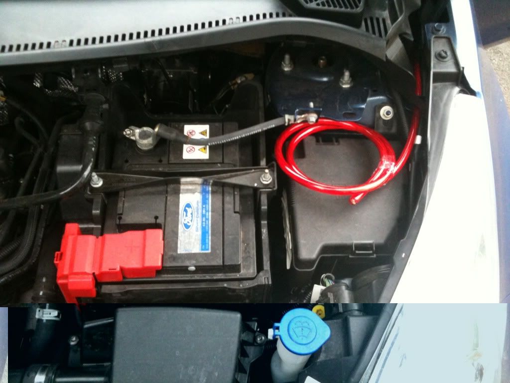

#25 sparticus5
sparticus5
  • New Member
  • 112 posts
  • Ford Model: 2010 Fiesta Zetec S 1.6Ti-VCT
Posted 15 October 2010 - 01:13 AM
"The power lead is obvious in the door shut however once wrapped with some black sheathing it should look fine".
Oh my God! Whatever you do, do NOT hook that power cable up. Rip it out and either a) take the advice of the above poster and route it thru the firewall or preferably B) have a professional install the amp.
I've installed many systems over the years - I've never actually though about installing anything in the latest Fiesta (I've certainly no intentions of doing so myself) but after having seen those pics, I'm curious as to where/how you intend to mount the amp? I'd have thought the most obvious / easiest place would have been under the front passenger seat but you've routed that power cable in the boot? Without lots of work, I can't see any where obvious to mount it.

My issue is that i have always used aftermarket HU's with rca outs already on the unit
This tried and tested method of using an rca converter however is new to me and that is where i need the help.
My amp arrived this morning.
As i am typing this i have just managed to get the rca and remote up to the head unit (with the help of a good old straightened metal coat hanger!)
Just need to connect the rca converter and remote lead to the multi block.. still struggling! :unsure:

And have decided to leave the power lead in-situ
Have fitted the fuse though now, and applied the trunking/sheathing
#30 jamham92
jamham92
  • New Member
  • 33 posts
Posted 15 October 2010 - 06:00 PM
hi
havnt managed to get pictures yet but there is no need to drill any holes in the grommets. i managed to get the power cable through the existing grommet and havnt had to drill anything at all. the wire simply comes through and then comes down behind the glovebox.. was a bit tricky to feed through but well worth it.
it does look a lot better tho now you have wrapped it!
