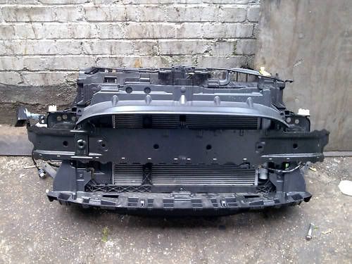

It could also be the internal design of the MK7 too as the radiator is positioned behind the front sub frame which as you can see in the pictures is blocking half of the radiator wouldn’t have been as bad had Ford positioned the cross beam at a 45 degree angle which would force the air that’s hitting it downwards aiding the cooling more,Ford could also have put bigger holes in front support bar,doing a DIY job on it would probably void warrenty and jeopardise safety, I’ve never seen a radiator mounted behind such a large sub frame before although the plus side is theirs less chance of getting your radiator bust, if hit from the front and also the handling is improved due to the radiator being closer to the front axle reducing under steer got these pictures off e-bay some guy has broken down a full brand new 1.6TDI MK7 Fiesta Crazy :o

Interesting comment about the sub-frame.
