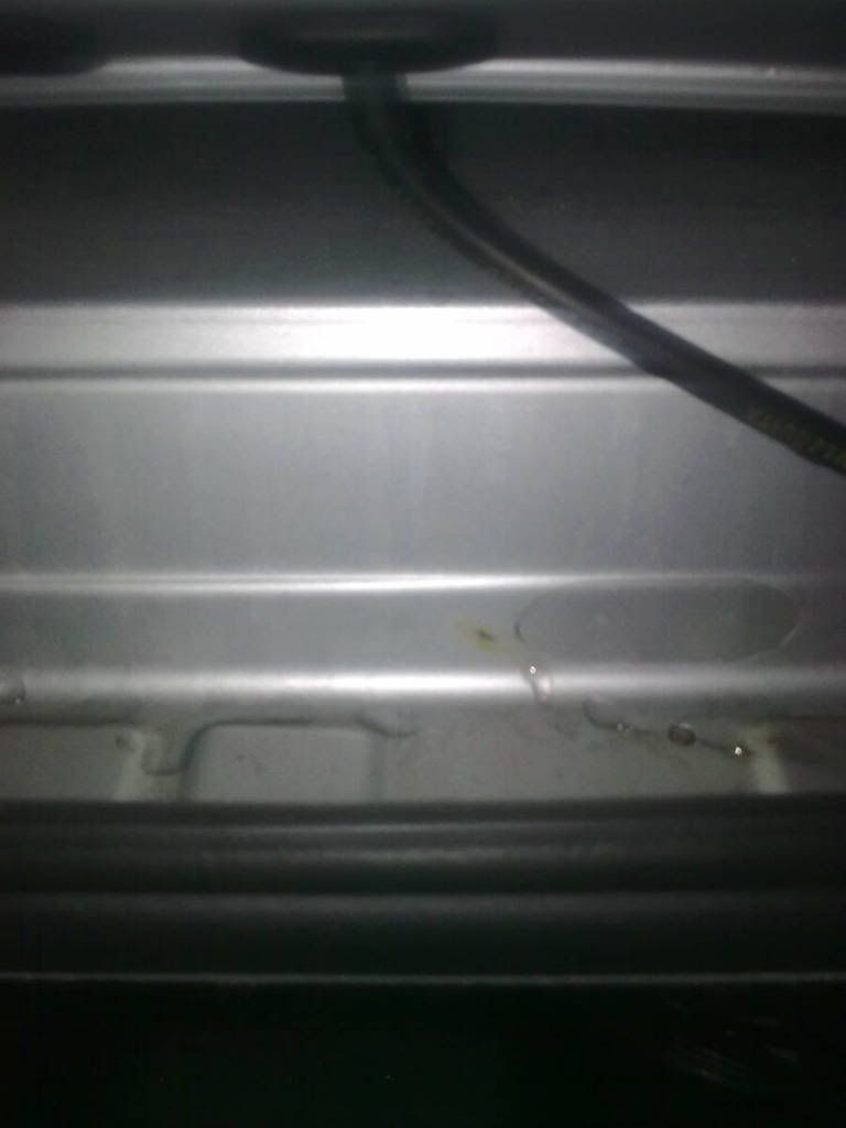

Lenny Posted February 13, 2011 Share Posted February 13, 2011 My focus was manufactured in July 2010 and its starting to rust in the boot panel, A spot behind the rubber elbow pipe carrying the cables in to the boot panel from the roof panel, can be seen when the boot is open, ill post a picture later, only problem is where do I stand with my warranty as I’ve fitted the ST rear spoiler to the car myself, although the spoiler doesn’t tough the part affected i may have voided a warranty as I’ve modified the car outside of a ford workshop. 1 Quote Link to comment Share on other sites More sharing options...

catch Posted February 13, 2011 Share Posted February 13, 2011 My focus was manufactured in July 2010 and its starting to rust in the boot panel, A spot behind the rubber elbow pipe carrying the cables in to the boot panel from the roof panel, can be seen when the boot is open, Lenny, you are not alone I have a 55 plate Mk2 with the exact same problem! I noticed it after buying it from a Ford Main Dealer on the 16th October 2009 [the car it's self was described in the advertisement as being "Franchise Approved"] Now when I noticed it I thought that was strange how it rusted there. Now because visiting the dealer I bought from, is a 44 mile round trip away. I did not look forward to the "leave it with us, we will have a look at it scenario. So I thought, it being where it is, I will sort it out, because an exact match to paint finish was not the issue with me. The fact I could kill the source of the rust was the issue. Anyway when I started cutting back the paint to treat the rust, it just appeared to grow! Now that could suggest that the car had this problem from the day it was built. But being 4 years old when I bought it, I could not say for sure. Anyway I patched it up, first cleaning and then treating the affected area with "Hammerite Kurust" treatment. I've used it before, in fact I used it on my badly rusted front wheel arches [another Ford design fault on the Mk2]and it works. Known rust problems on mk2 Focus front wheel arches Honest John says Ford did a fix But of course that rust damage was not coming from behind the paint finish, it was caused by road grit grinding down the paint protection. Coincidently the Mk1 Focus had sills made out of rust immune composite material. With the Mk2 they took a backward step in that area. Then a year after production started on the Mk2, they realised they had a problem, so from 06 builds onwards they introduced a "compromise fix" Now it would appear from early photo's of the new Mk3 they have learned their lesson and reintroduced the composite sills., first seen on the Mk1. Anyway I digress.... So back to the problem under discussion, I treated the boot area and painted it, well I just notice the other week it is striking through again. Now that proves to me it is a build problem with the car,in that the car is rusting from the inside out. I also had to do rust remedial work around where the rubberised cable pipe enters the bulkhead of the car. Now I only decided yesterday to take the issue up with Ford customer services. Then you post the exact same problem the day after, in a car built 5 years later, how weird is that ! Photo 1: Taken late October 09, prior to remedial work. Photo 2: Paint work cut back prior to rust cure treatment applications. When I get dressed, I'm just sat here with a thong on at the moment [only joking] I'll nip out and take some more photo's, as I'll need them as part of my communications with Ford. ill post a picture later Yes that would be good, a close up one and one showing the top of the rear opening bulkhead, along with the top of the door. [just so others can see exactly what the problem is. only problem is where do I stand with my warranty as I’ve fitted the ST rear spoiler to the car myself, although the spoiler doesn’t tough the part affected i may have voided a warranty as I’ve modified the car outside of a ford workshop. I don't think that is an issue, what you have done in no way contributed to the problem under discussion. And as I appear to have the same issue, it is not a "one off" And on that basis it is reasonable to assume many more owners out there have the same issue. I would say it indicates it is obviously a design and or build issue with the Mk2 family of Focus's We must keep in touch in regard to how we get on when we individually contact Ford over the issue. And it will not harm our causes if we let them known we are aware of other people having the same problem on cars built five years apart. I myself would be prepared to test my case in the small claims court, if I don't get satisfaction from Ford UK. A car with a 12 year perforation warranty, breaking out in rust blisters after 4 years. And it happening to cars built five years later, showing a rust problem in less than a year after manufacture. That in an area of the vehicle not exposed to the weather, or degradation to the paint finish by road grit or stones thrown up ! I can hazard a guess in who's favour a judgement would be made. Quote Link to comment Share on other sites More sharing options...

catch Posted February 13, 2011 Share Posted February 13, 2011 on this picture you can also see where I've treated rust forming around the hole in the bulkhead that is filled by a grommet enclosing the pipe that takes water to the rear washer jet. This picture: is it the washer water supply pipe grommet assembly where it enters the tail gate, causing the initial paint break down. In that when the tail gate closes it has at some time in it's life been the culprit? Who knows? But actually looking at the photo, I reckon the grommet will not sit in line with the rusty area when the tail gate is closed. Possibly I should attempt to expose the rear of this metal work by removing the roof lining at the back of the cabin. Never having had the head lining of a car, could anybody who has advise me best way to go about it. And does it go back OK, and will it expose the rear of the actual metal roof or bulkhead panels, or is some form of sound proofing stuck to the actual underside of the roof? Edit: Having just been out and had a look at the roof lining, it looks like it has to come out as one whole unit. taking plastic trim of the front and rear pillars, including the C pillars, the four grab handles, all the door openings weather proof rubber mouldings, two retaining clips pushed into the roof lining behind and above the rear seats.......in short not a small job Quote Link to comment Share on other sites More sharing options...

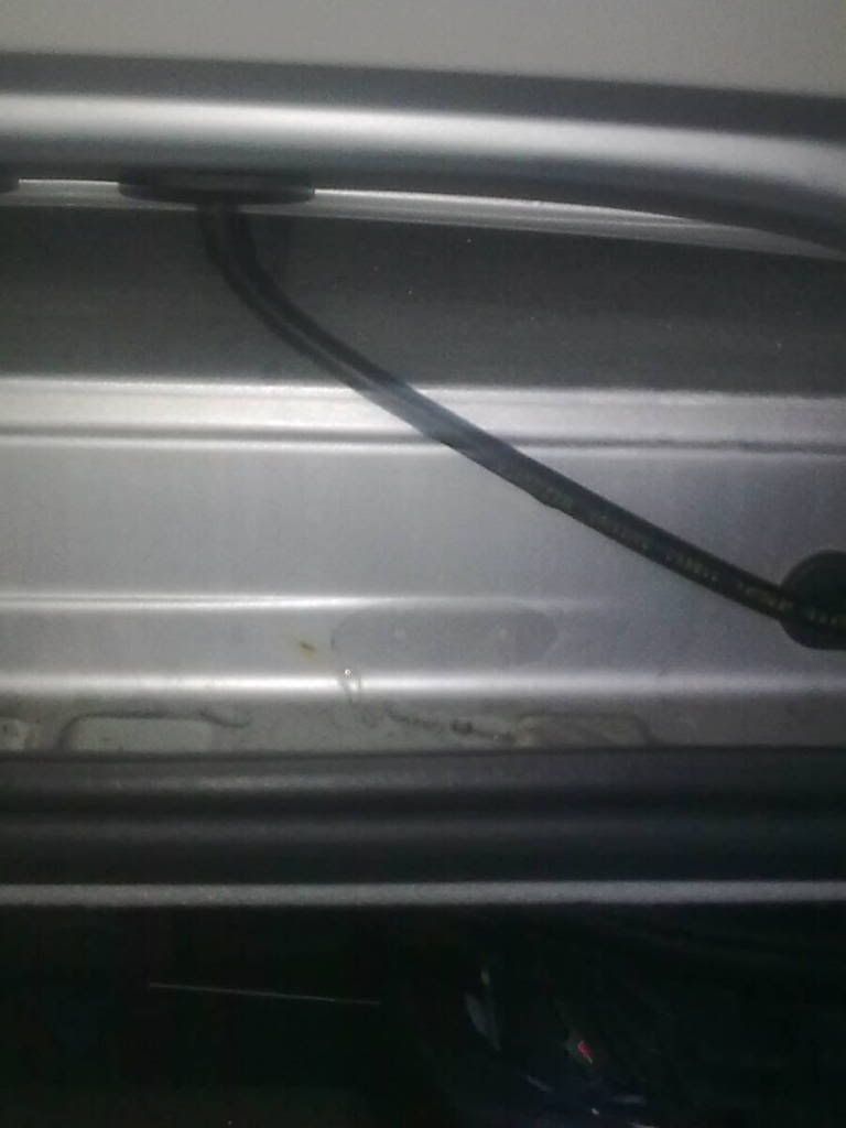

Lenny Posted February 13, 2011 Author Share Posted February 13, 2011 Thanks for all your information Catch, shocking to hear your having the same problem i also live 40minutes away from my local dealer, who is an ignorent pig starting to wonder who got what in the scrappage deal, First noticed it 3 weeks ago when I opened the boot I saw like a snail trail of rust on the top, so I wiped it clean, don’t use the boot that often roughly 12 times since I bought the car so here it is 3 weeks later since i spotted it. only have the car since october bought it from the ford dealer direct, was a test drive model 1 Quote Link to comment Share on other sites More sharing options...

catch Posted February 15, 2011 Share Posted February 15, 2011 artscot79, you have fricking gone and done it again this double posting of image posts doesn't half make reading the thread a ball ache. Lenny, any chance of a couple of brighter lit, higher resolution photo's of the damage? My photo's were taken with a 6 mega pixel camera. Reason I'm asking is this, I'm going to contact Ford UK. I ain't wasting my time with a main dealer who because they cannot be bothered will just come up with all sorts of reasons why it ain't their problem. No, I'm going to approach Ford, and put the argument to them that it is a build issue. An issue that has been there from day one on the Mk2/2.5 models. And indeed it was still there right up to the last build of the Mk2.5 model. And to do that I need to send them clear crisp photo's that will stand up to being magnified under inspection. Getting Ford UK to accept it is a build quality issue is the way to go IMHO. Because unless they do, your local main dealer ain't going to do the work because he will not be able to bill Ford UK for rectifying the problem. I have taken on all sorts of manufactures, or suppliers that produce faulty components/ goods/ services and have not lost a complaint yet. And I'll tell you this, it's the first initial contact that is important, you have to present them with evidence that stands up to scrutiny. At the same time in this particular instance impressing on them you are aware of other owners with the same problem in the exact same area. Because what your actually attempting to do in your first communique. Is making sure the email opener who first reads your complaint passes it up the food chain to somebody who has the authority to up hold your complaint. Other wise you will just get the stock reply, you will have to take it up with the dealer who sold you the vehicle. I'll be honest here, you do have a better chance of getting it sorted at dealer level, better than me as my car is over five years old now, hence I'm not even contemplating the dealer option.And that being the case I want to use photo's of you fault when I present my complaint to Ford UK. And besides if you take it to a dealer, they may just blow it over, not actually remedy the problem. Then your back in a year eighteen months time with the same problem. So best go to Ford UK directly and get them to admit it's a build problem IMHO. Quote Link to comment Share on other sites More sharing options...
Lenny Posted February 16, 2011 Author Share Posted February 16, 2011 artscot79, you have fricking gone and done it again this double posting of image posts doesn't half make reading the thread a ball ache. Lenny, any chance of a couple of brighter lit, higher resolution photo's of the damage? My photo's were taken with a 6 mega pixel camera. Sorry mate, Ive only got my Nokia Phone 2.5Mega Pixle, also dont know if theirs a ford ireland but as far as im aware their all imported directly from the uk if you need any further information or if i can be of further assistance contact me, im more in favour of reporting it to ford and getting my local panel beather to repair the rust as i would feel more confident that the rust was actualy repaired rather than a skim of paint on to cover it until warrenty expires as their a shower of !Removed!'s in my local dealership, sales man had an attitude with me straight away. which got worse when i told him i would buy my accessories from foed uk as their cheaper and post to my address cheaper than two 45minute trips to his garage. Quote Link to comment Share on other sites More sharing options...

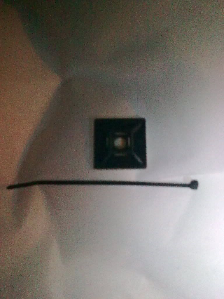

catch Posted April 13, 2011 Share Posted April 13, 2011 Just so Daryll does not think I'm picking on him ;).............I see "top banana" did not come back with his feed back as promised In regard to my motor, when I did the fix, applying Kurust rust curing treatment. I did two coats of this within the hour, then three hours to let it cure, before applying undercoat filler [as per instructions ] Then left 24 hours [as per instructions] before applying colour coats. And a few days later I applied a couple of coats of lacquer. During all these applications, I left the boot lid open for at least 4 hours [with the boot lamp removed] So the applications which would not have hardened, were not subjected to stress by the offending rubber pipe configuration. And when I did eventually close the boot lid and used the car, I temporarily fixed that rubber pad I had made with some black UPVC electrical tape applied to the upper edge of the pad [flap like] In fact I've had a re think since my last post, and I've decided to re a fix it as above. That way whilst relieving the stress of that pipe on the paint work [as I think it's that raised leading edge of the grommet where it is welded to the length of pipe, that does the damage] OK I accept that to some peeps it will sound like a lot of faffing about. But this way I will be able to lift the flap 14 months down the road and see if rust is breaking through from behind the fix. As it did last time I did a quick rushed fix. I'm just the kind of guy who wants conclusive proof as to what is happening. For instance, peeps catching it early might have better results than people like me who buy a motor four years old, and the rust has had all that time to eat it's way into the bulkhead. Of course Lenny's way, using a fixing to pull the offending joint back from the paint finish will achieve the same results as my pad. 1 Quote Link to comment Share on other sites More sharing options...

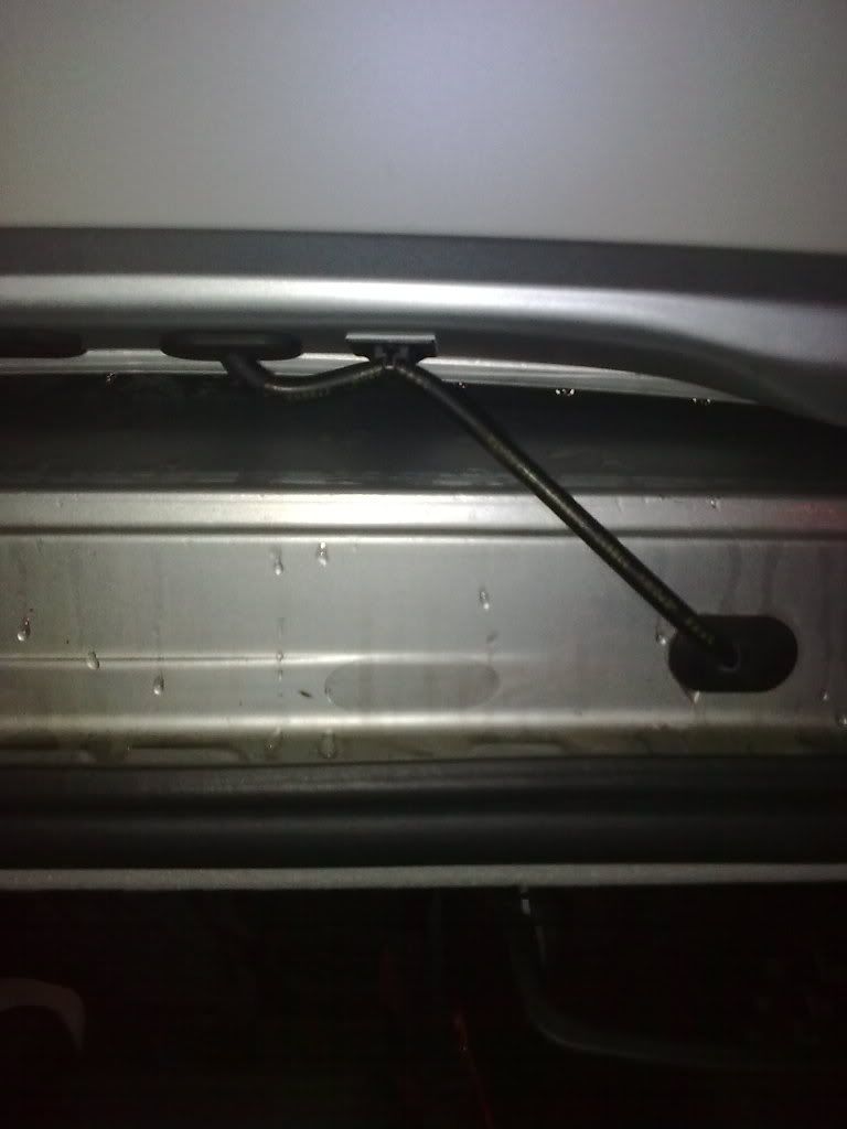

top banana Posted April 13, 2011 Share Posted April 13, 2011 well, mine has been in for repair and picking it up for repair tomorrow or monday, under warranty. keep you updated on repair sorry for not replying sooner, bad family things going on. well, car was at the Ford bodyshop for 2 days, and the rear panel where the rust was has been resprayed, but Ford also supplied the bodyshop with the stonechip protection sheet to stick to the area where the rust was. Hmmm so they are aware of the issue then, as the supplied a remidial part to prevent from happening again??!! all seems good nearly 1 month on. Mine was the 2nd car they had in for this fault in March#! Quote Link to comment Share on other sites More sharing options...
catch Posted April 13, 2011 Share Posted April 13, 2011 Hope the family issues get sorted soon mate. And I hope you did not mind the tongue in check ribbing I give you. And thanks for the feed back, out of interest how big was the stone chip protection sheet they supplied to the spray shop? A photo of same in situ would be even better, or has it been blended into the body work and sprayed over to be nigh on invisible. 1 Quote Link to comment Share on other sites More sharing options...

Daryll Posted April 15, 2011 Share Posted April 15, 2011 ok, I intended to take a pic, but never got around to it... now you've shamed me into it..! <_< Mine isn't as big as you guys but its there, in the same place. also, my washer pipe seems to be stretched pretty tight, so I'm not sure I could use the cable tie method. 1 Quote Link to comment Share on other sites More sharing options...
catch Posted April 15, 2011 Share Posted April 15, 2011 Yours and Lenny's are about the same size, mine being a 55 plate, build date October 2005, just shows you how the rust spreads if it is not remedied. So just on our forum we have found the same fault in 05 build [start of the Mk2 model] in 07, 08, 09 and 2010 build vehicles....right up until the last Mk2.5 rolls off the production line We now have conclusive proof that it is a design flaw or production line flaw that was designed into the original Mk2 Focus in 2005 and Ford have ignored it for five years, and the flaw will been in the very last Mk2.5 model that rolls of the production line. FORD MANAGEMENT, YOUR A SHOWER OF SH@T THE LOT OF YOU 1 Quote Link to comment Share on other sites More sharing options...
