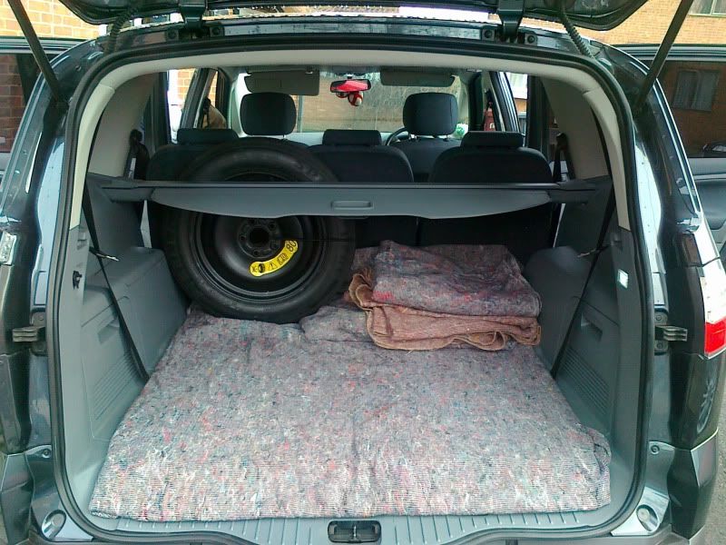

Posted 06 February 2012 - 05:56 PM
How i store my space saver in the Smax just in case.
#11 137699
137699
  • 213 posts
  • Ford Model: 2006 S-max Titanium X Sport 2.5T
Posted 06 February 2012 - 06:15 PM
Yes, but what's the word from your insurance company?
#12 Jon Hunt
Jon Hunt
  • 35 posts
  • Name: Jon
  • Ford Model: Mondeo
  • Year: 2002
  • Location: Berkshire
Posted 07 February 2012 - 12:44 PM
mate it a spare to get ya out of agg and to a garage for some rubber thats all it design to do and what it will be used for.
