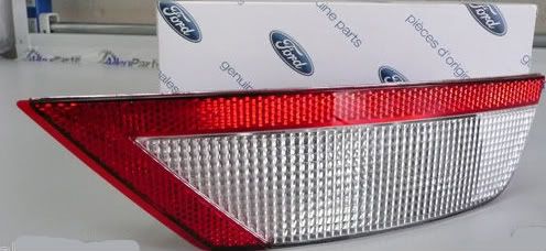

Genuine Ford Part and a direct replacement to the original unit, Click Here to Purchase
or Shop Around for a Better Deal.Posted Image
Ive updated the bottom of the post with a list of suppliers, prices varey
Simply ensure your handbrake is on,
then lye under the rear of the car at the rear of the fog light unit you will see two thin long black blades like rulers, press these in towards the rear of the fog light unit and push out to the rear of the car.
Remove the bulb unit and replace with a red tinted bulb Click Here
or a Cree Q5 Led Red Fog light Bulb Click Here
Replace fog unit with the clear unit and gently push in to place,
Job Done and 100% Compliant also E marked and a genuine Ford part.

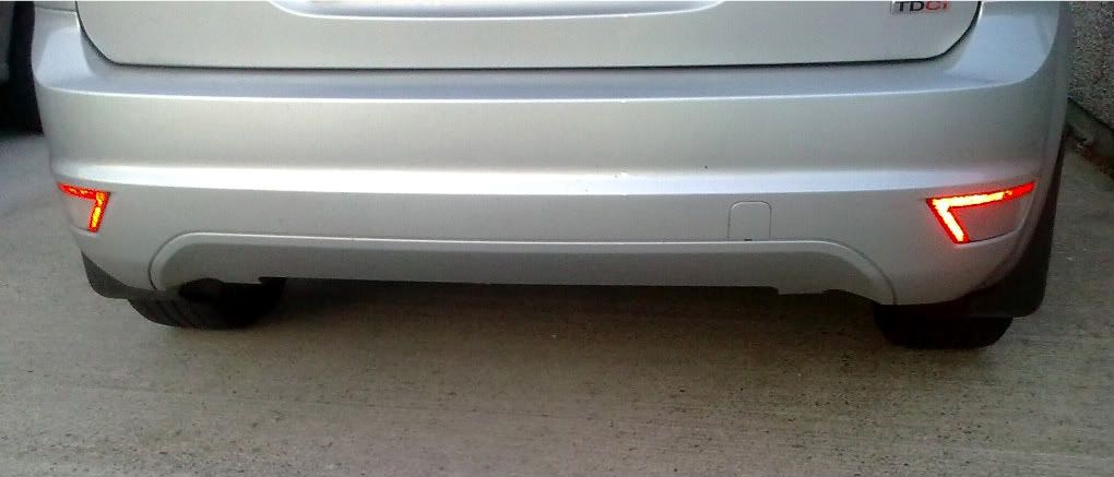

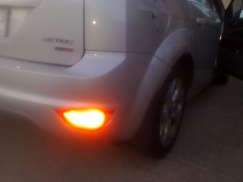

i had the Silvatec fog bulb fitted and i later removed due to it emitting a Pink light rather than a Red and as you can see in the pictures below, the red bulb is not that noticeable in the fog unit.Posted Image

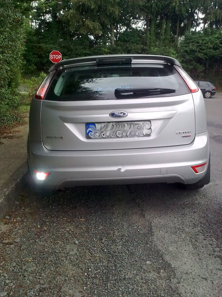

While your on your back why not convert the reverse bulb to a Cree Q5
Click Here and also
