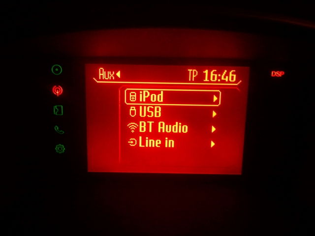

Thanks to Nath we can safely say this can be done provided you have the hardware and someone who can be bothered to use IDS rather than fobbing you off with crap like 'it can only be done from factory'
Oh and my personal highlight.... SPOTIFY WORKS OVER STREAMING inc track display!!! Oh I'm happy. Now to find a cheap module :)
This is for anyone who commented or took an interest in that mammouth 'USB can it be done' thread. Get ringing scrappies and talk to nath.

Suppose I'll be nice and let you guys know what's required ;)
1754709 - Fiesta 2010-Module Bluetooth BT/VC+ USB Connect (with Voice Activated Module English)
1497339 - Fiesta 2010-Control Assy Headphone Volume 3.5MM BT/VC Phone Interface + USB Connect [far right in pic] 1715190
1572824 - Fiesta 2010-Centre Console Cover BT/VC Phone Interface + USB Connect [middle in pic]
Posted Image (you should already have the AUX input [far left in pic)
1633151 - Fiesta 2010-Wiring BT/VC Phone Interface + USB Connect 1710952
Then a dealer or person with access to Ford VCM + IDS software with a few mins to spare.
If you have any questions ask away or PM me :)
