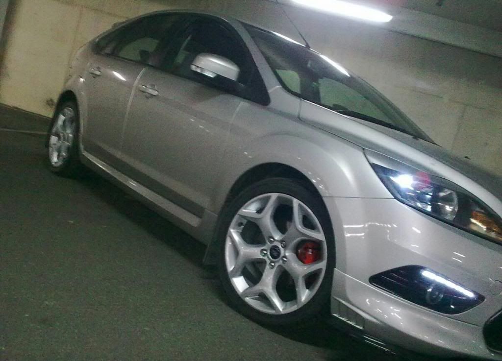

hi Kye,
Although most cars now released dont have any parking bulbs in the front atall, there using drl strips instead,
The MOT crew may not like the idea of your drl's not dimming until your dipped beam becomes active,
To be honest the drl strips in these kits are manufactured by OSRAM and custom fitted to the focus fog light housing in china, these drl units are pretty bright on full beam mate, i switch on my parking lights in order to dim the drl's at dusk or in underground car parks to prevent blinding other drivers.
You could always run a cable to a switch in the drivers footwell allowing you to disable/over-ride the dim feature leaving them full beam along with the side lights,
But heres a picture of the drls on dipped beam along with some 6000Kelvin parking bulbs
