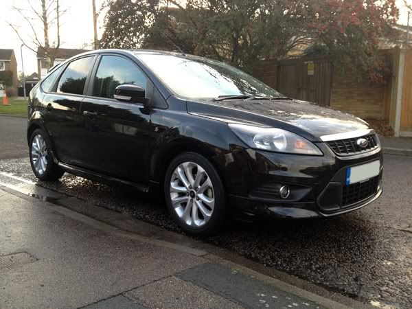

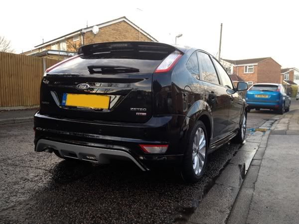

Little update, Nothing major... Finally got the mix sorted on my snowfoam.. and the trick of adding a little shampoo, certainly made it able to be left to dwell longer!!
Just a couple of pics of her clean!
