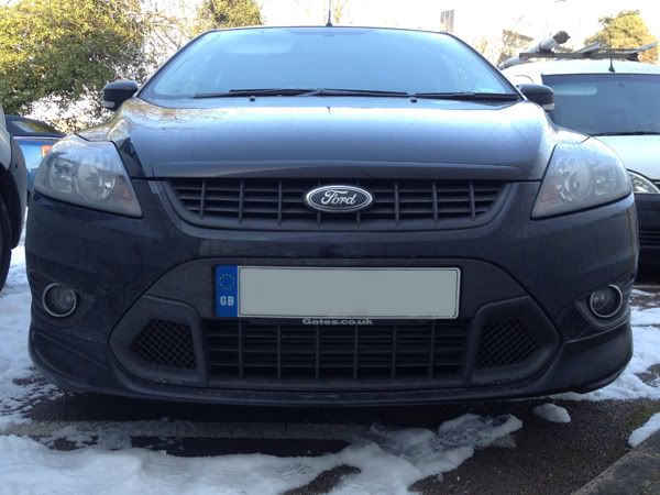

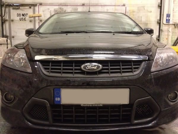

Just a little cosmetic update... Got bored of my chrome strip at long last... Painted it black.
In Other news... HOW DIRTY IS MY CAR!!!
Thats almost criminal!
#38 Lenny
    Resident Sherpa
  • 5,375 posts
  • Location:Ireland
Posted 11 February 2012 - 03:54 PM
looks great mate,
makes the car seem lower and wider in my opinion,
and your car is very dusty lol from the roads, time to take out the sponge and soap lol

I see what you mean lenny... I also like it because thats what they do with the ST... So next on the list is to colour code the Fog Surrounds and the Chrome Bezels...
