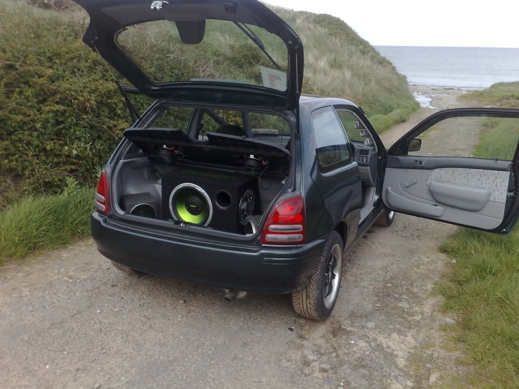

I used to have a 1.3 Starlet i kitted out with a load of fusion speakers lol had to build wooden rings like washers to raise the cone of the parcel shelve 6x9's so as the shelve would sit flush and up from the sub when closed
