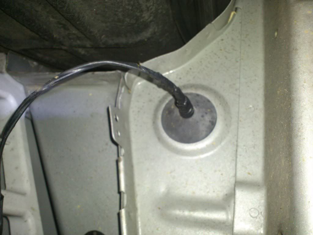

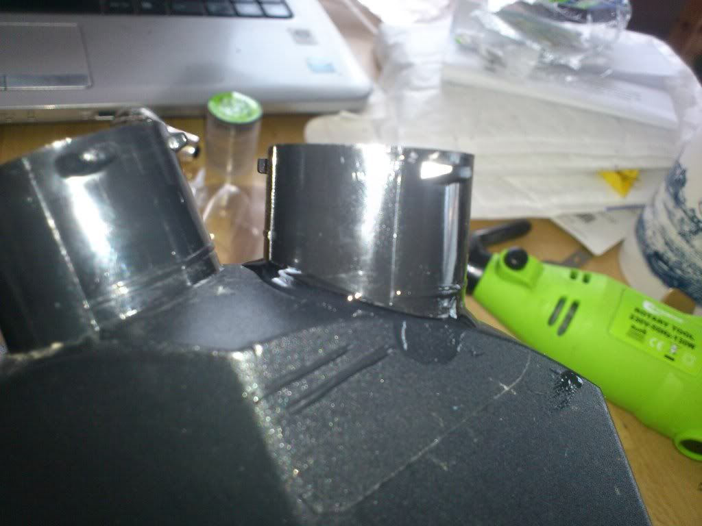

  • You should now have a bulb socket for the second reverse light with a red and black cable spliced on to the rear of it, with just enough length to attach it to the exiting reverse loom,
  • For those who may be interested in doing this on the mk2, heres a few tips/pointers, Its almost the same as the mk2.5 just a few suttle differences with where the holes need to be drilled out etc.. S
