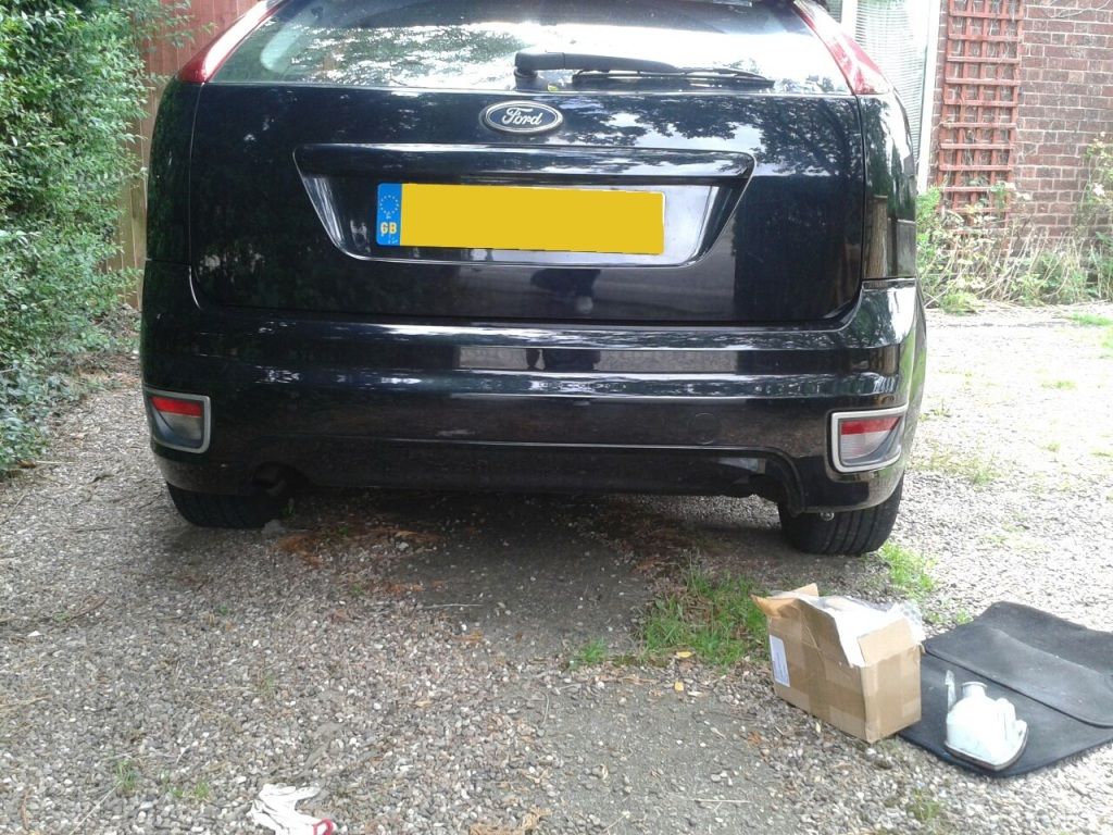

Pretty much mate yea, was less than pleasant! I want this offside clear foglight:
Lol why weren't it pleasant mate? How much water was in it?
Just get the 20quid none genuine ford unit I linked, it looks exactly the same so once it's in you'd never know. Also, if you ever do decide to do the second reverse light (cause it's really a pish easy n well worth mod) you will have to cut a hole in the markings on the back anyway so no point paying extra for the genuine one.

After reading this tread, I began to dislike the unclean look of one red and one white lights on my car. I did not go all the way with reverse lights on both sides. Just exchanged the red one with a reverse light and equipped it with a red Cree. Looks better end works fine:
Looks much better mate,
Keep hold of your red unit, you may wish to fit a dual function unit in the future.
