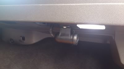

Finally fitted the socket.
Easy job, hardest part was working out where to put it.
Being belt and braces i've added a 15A inline blade fuse to the live cable just in case of surges.
I have the habit of blowing fuses when fiddling with the car so thought it prudent to fit an extra one.
Surprisingly i found something useful at Halfords - LED fuses, if they blow a small LED lights up on them as a visual indicator.
Anyone else seen/used them before?

Nice job mate,
never saw the led fuse holders before mate sounds good.
