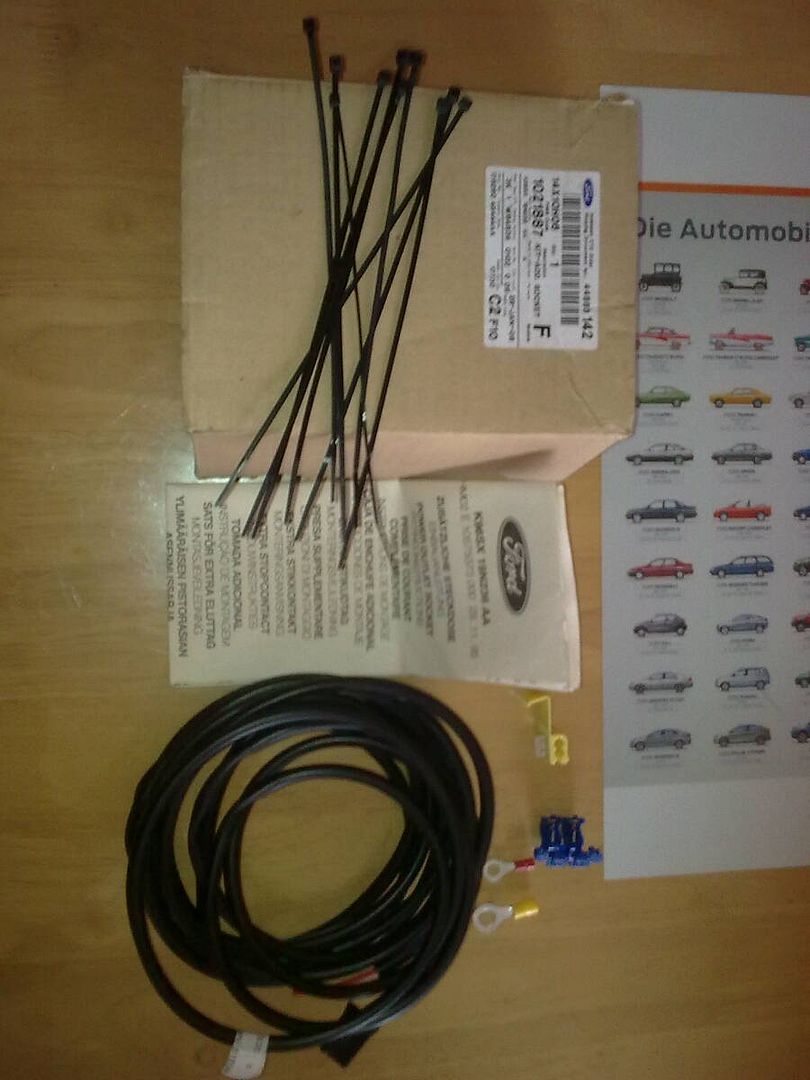

  • Finally!! Given that yesterday was the first chance in a long time I got to spend a couple of hours on the car, I thought I'd make the most of it! Using the length of wire and plug that Lenny kindly
  • I know mate, about time! Didn't need to tap into an earth, just followed the guide for that part. When i bought the socket it came with the plug and a few inches of wiring. I just removed the spade ty
