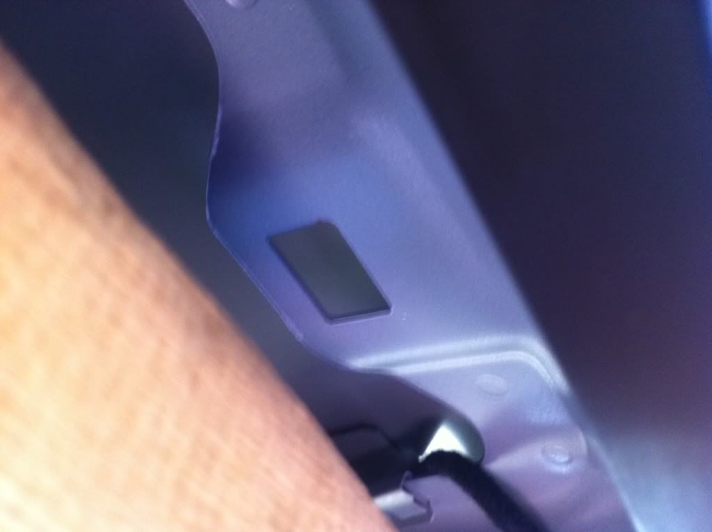

Firstly, You need to pull the A pillar covers off. They're the supports running up either side of the windscreen. SImply put a few fingers in behind the top and pull firmly but evenly. It will sound like its snapping but just keep pulling. They are stepped clips, meaning that they have different distances they can clip in to, so the first few clicks when removing or replacing doesn't mean its all the way there. There are three of these clips along the cover, as well as three simple pegs that fit into holes in the metal support. The clips on the cover are white, and the receivers are black, just so you know what lines up where.
Then I prised off the covers to reveal the mounts for them

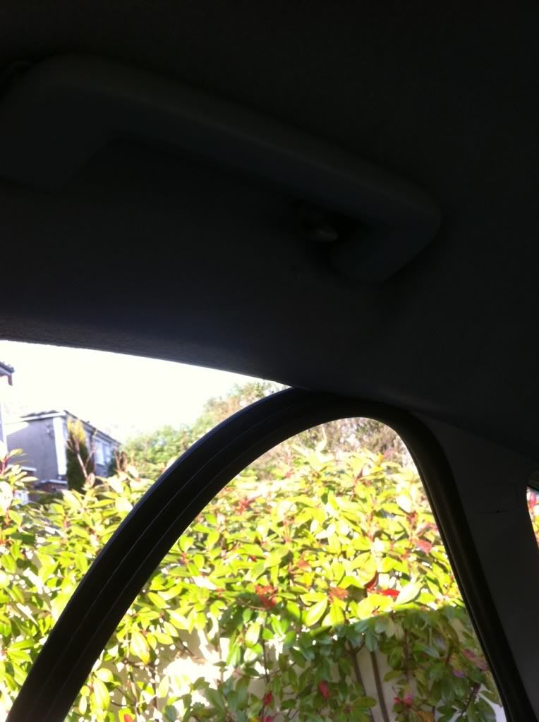

you can see the difference in the mounts from the handle and the covers. A flat head screw driver under the flap on the handle will lift it to reveal a screw on each handle mount.

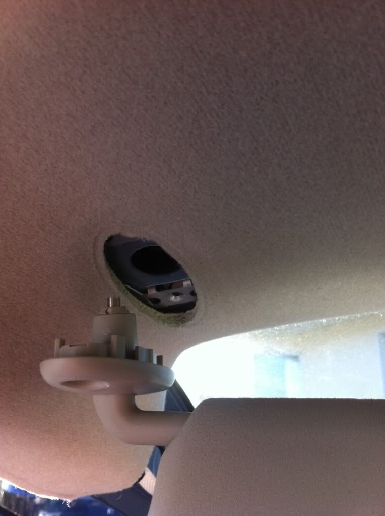

Remove the two screws holding the visor on

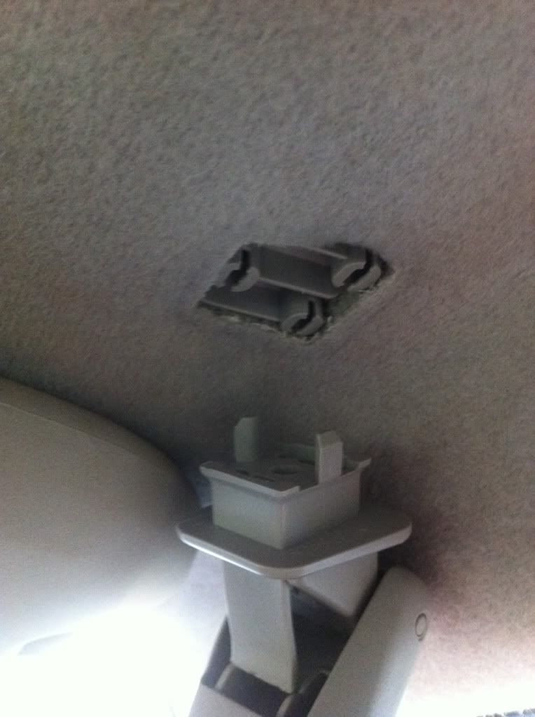

once this is all free you need to work your hand in above the headliner to release the mounting points for the handle.

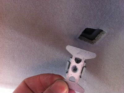

They are simple metal clips that are pushed up through these metal holes.

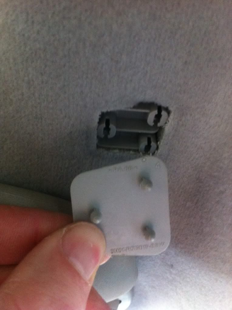

If you have the covers, the receivers for these are simply sitting on top op the headliner and come off with absolute ease. Just push them up a bit once the headliner is free.
You need to squeeze the clip so that it fits back through the hole. Its not to hard, but you need a fair amount of force. I only pushed the side of the clip furthest from the door and it started to come back through, once it starts it pulls out easily enough.
Then you simply push these clips into the two holes on the side you want the handle, replace the headliner by the seatbelt, screw in the visor and replace the A pillar cover (make sure you have the headliner behind the cover) then replace the rubber seal and finally screw in the handle.
If you have the covers, you need to place the receiver in above the headliner on the side where you removed the handle and put the visible cover on. Remember, the side with 1 clip goes to the inside of the car.
