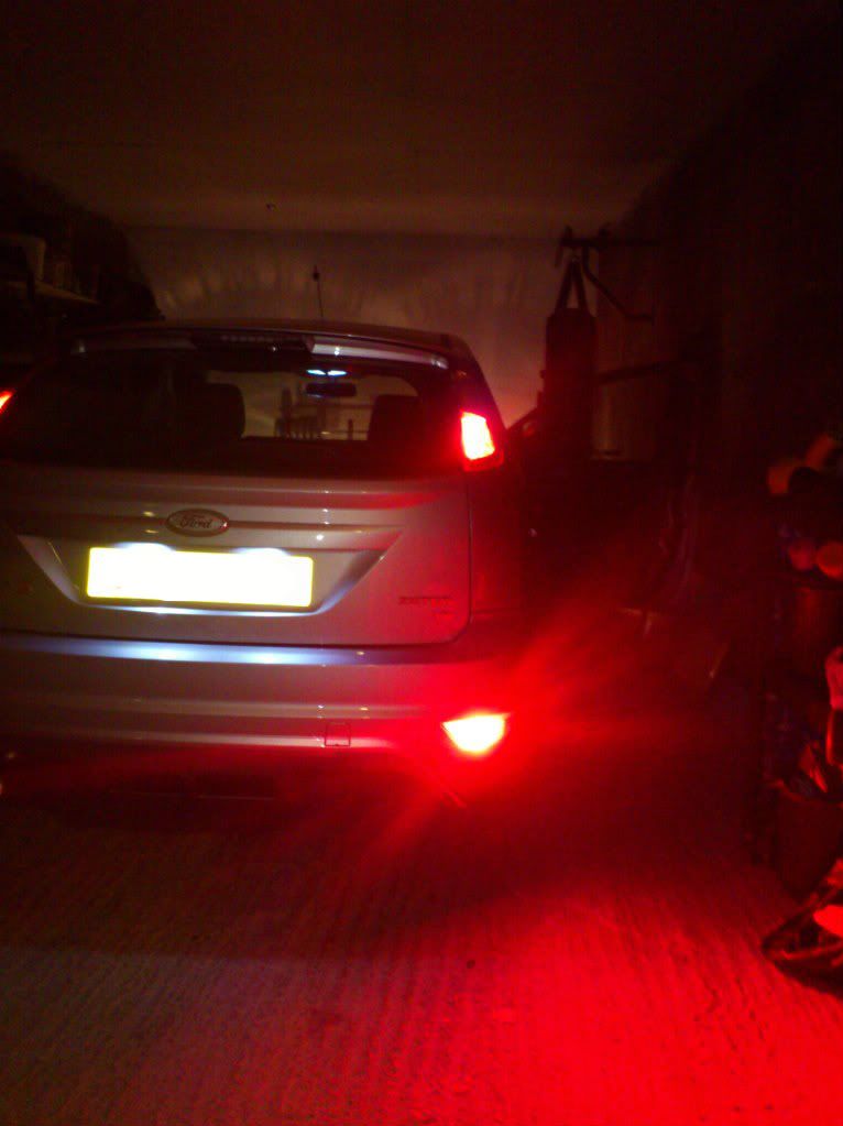

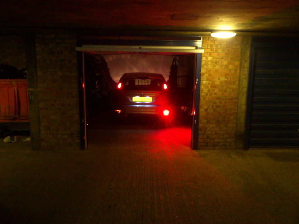

here you go mate, as promised
DSC_0327.jpgDSC_0326.jpgthese pics give you an idea of the strength, but seen as you have ordered it i will let the bulb do the talking lol
Thanks for the pics, looks great, much better than my red bulb, cant wait for mine to arrive now.
