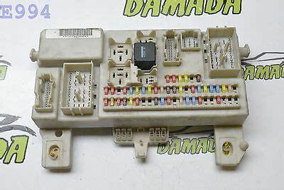

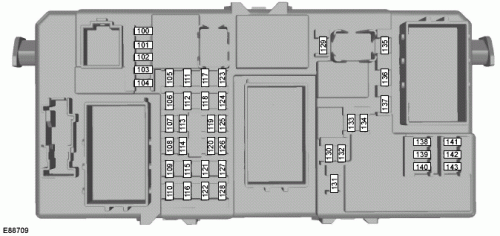

Hi I thought this might an interesting simple mod. Had a look at my GEM (CF type post face lift 2A) no contacts for fuses 110 113 & 135 nor relay R15. So a none starter for me.

Hi check my fuse box just to see the fuses and wires if they exist.I see at f45 i have no fuse,at f48 ihave 20A, at f71 i have no fuse.Next check the connector and i see is already have cable at pin 1 and 26 .I have rain sensor and  lights switch with auto option
https://www.dropbox....103936.jpg?dl=0
https://www.dropbox....103946.jpg?dl=0
https://www.dropbox....104420.jpg?dl=0
Because i have already the cable at pin 1 and 26 is this means that is  bridged.?
