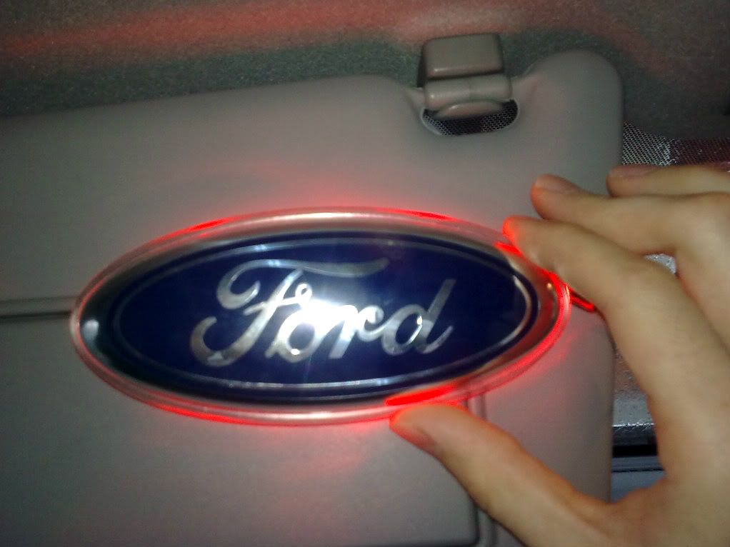

#11 Lenny
    Resident Sherpa
  • 5,325 posts
  • Location:Ireland
Posted 11 February 2012 - 09:36 AM
True, true. Plus it's a nice upgrade which I believe can help insurance as there's extra brake light cover. If I recall my dad could save £10 a year if I do this by declaring a third brake light.
i didnt know that mate,
im less reluctant to report my fourth brake light now lol i thought it would put my insurance higher.
Posted ImagePosted Image
