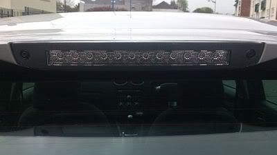

Added another item to mine too -
Cheers mate ill e-mail him after work and where did u get that led break light from? And how much?
Ooooow stoney where did you get your clear brake light from me like.
Available on eBay.
I paid £29 but there are some for £39 which to me look exactly the same.
looks much better next to the moondust silver paint work,
i reckon it would be brighter than the red lensed one too,
Still haven't got around to taking night photos yet.
Been a tad busy at work lately.
I'll post some up when I get some time to myself.
Going from 5 wedge bulbs to 12 LED's will have to make a fairly big difference though.
What did u search on ebay mate?
Yep, that's the one.
Only differences in fitting are that the wire connector comes out of the back instead of the side so as to allow the longer light spread (lines up with the recess inside the spoiler so no problem) and the foam seal is not so floppy and annoying to fit.
Looks far better though.
