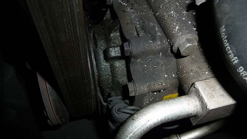

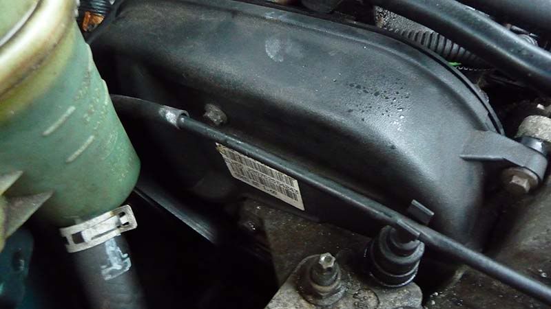

So is this actually the fanbelt, cant you see the cambelt at all?
I take it this is the cover and if i undo these top bolts i can see the belt inside?

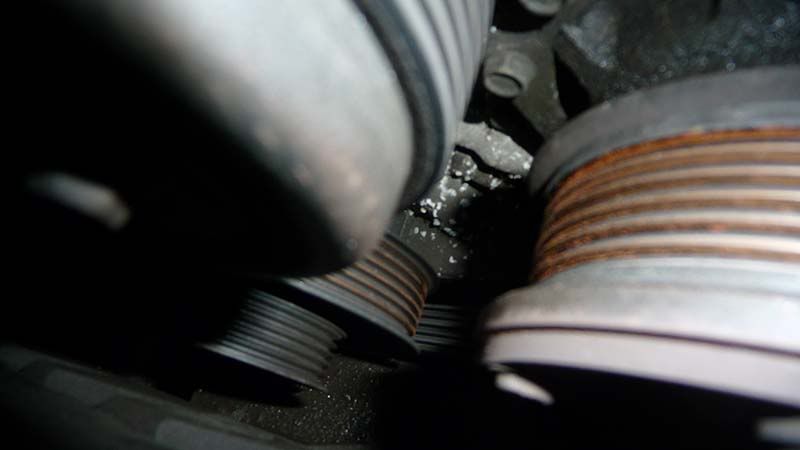

Also a lot of white crystals about, what could this be, something leaked, be the cause?
looks like the indication of a failed water pump which i,m not 100% sure runs off the cam belt on these have you any water loss did it over heat mind you even if its a head gaket /pump failure just a cheap if not cheaper to replace engine anyhow once youve had head skimmed new gaskets timing belt fluids filter labour not trying to put you off just the way it is cost wise was there any sort of rumble before hand from the engine maybe days before another way to tell if valves have hit the pistons in the event of cambelt failure is to manually turn the engine with a spanner/wrench on the crank pully out of gear of cause it should jam at a point if the timing has gone best done with the plugs out so no compression
the water pump on these engines is driven from the auxiliary drive belt - the pulley for it can be seen in the pics.
