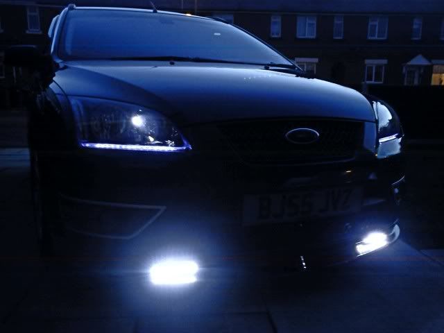

Now to start off with... I've fitted these lights below the bumper, but above the atermarket splitter (the bumper is an ST item) The lights fill the space between splitter and bumper pretty well, and despite the lights "cheapness", they seem pretty fliipin alright! B)
Oh, and they are E-marked too ;)
I've kept the wiring in simple... The "white" light is straight in to the sidelights circuit...The orange (indicator) section, directly in to the relevent indicator circuits.
There are no fancy interfaces, the lights themselves contain all the relevent circuitry... The indicators, (when activated) overides the DRL on that particular light as the indicators flash.
( I did a small video of the lights in action, but i deleted it before i uploaded it to photobucket,as the video wasn't an accurate portrayal of how the lights actually worked... The integrated indicators are LED, whereas the factory indicators are still filament bulbs, so the LED's operate slightly "quicker" than the factory indicators. In real life the timing can only just be made out, in the vid, it was a mile out! I'll do a short updated vid when i've installed some LED indicator bulbs in the Factory headlights so everything is in sync)
I'll let the piccies do the talking now....
Sidelights on (so DRL's on also)

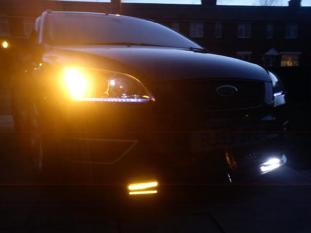

Sidelights still on, but with indicator flashing,so the DRL indicator "takes over" the white light....
The DRL indicator still works with the sidelights off also (in other words, the white DRL's don't HAVE to be lit for the indicator section to operate)
Quite nifty i think,and quite eyecatching (without being "in your face") B)
