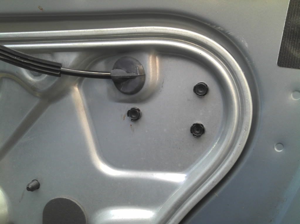

HI can anyone suggest to me how i remove the inner panel as pictured, i still have 3 screws or what ever they are and they seem to be still holding the panel in place and i have no idea how to get them off?

Try pulling the inner plug out with a pair of pliers, it looks like the plug is inserted to expand the pegs.
ive managed to get them off now, they push inwards and pop off. I was hoping to take the dorr latch out and replace it but i still cant get to it, looks like i have to drill some rivits out to get the inner panel off, so i give up now im going to have to take it somewhere to be done

That looks like the inner panel from the mk2 rear door. According to the haynes manual, there are just 9 bolts securing the inner panel, amd 4 bolts securing the lock. The window regulators are riveted, but lock dosnt appear to be...
