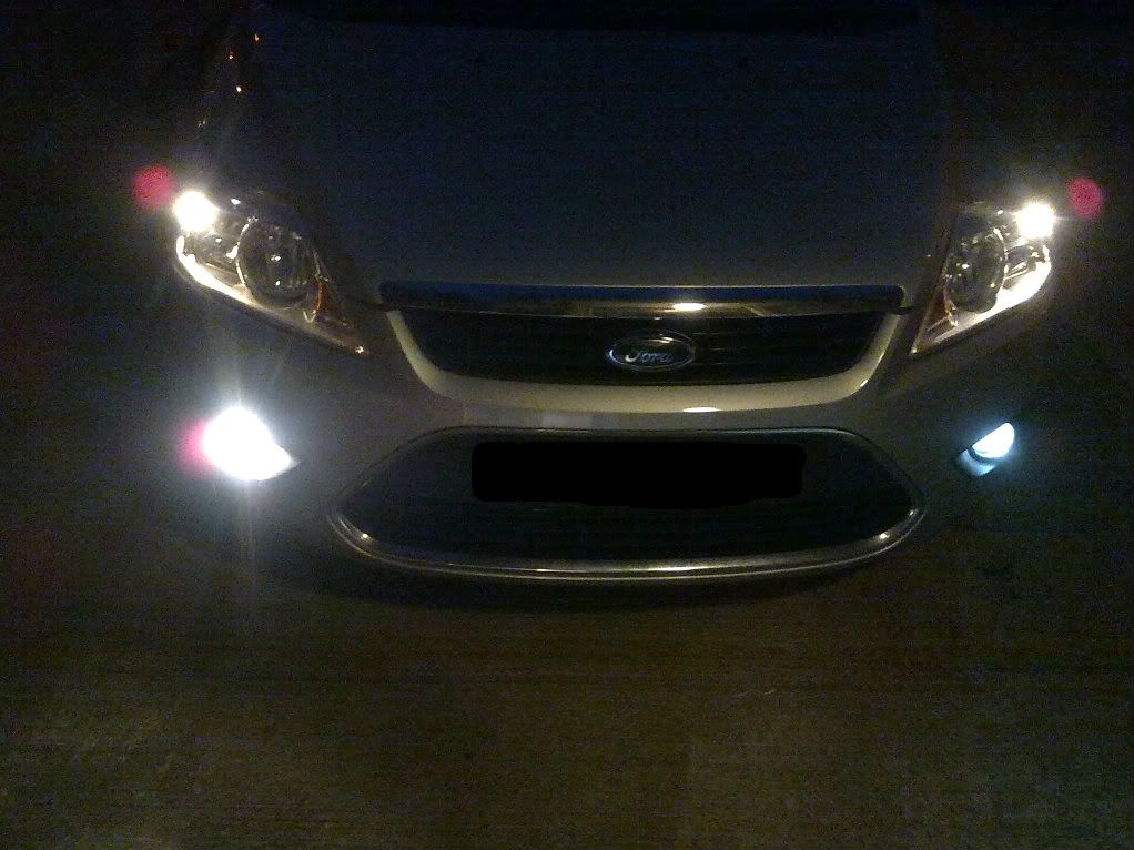

first picture below is the stock h11 in the left and the cree Q5 in the right
Below is the Cree Q5 H11 fitted in both units.

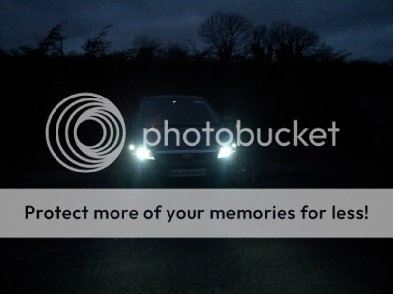

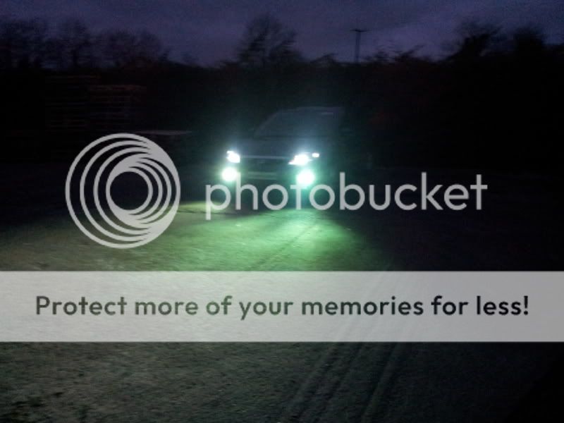

Ive also fitted a set of ST xenon headlights. I wanted to get 6000k bulbs to match the hids i have in the fogs. Anyway i ordered them and when they arrived they turned out to be 8000k. They worked a treat and not as blue as i thought they would have been.
Heres a pic with the 8000k bulbs
and a shot with the 6000k hids in the fogs
Cheers mate, they make a huge difference campared to the hids i had in my standard headlights. The glare from them was unbelievable
