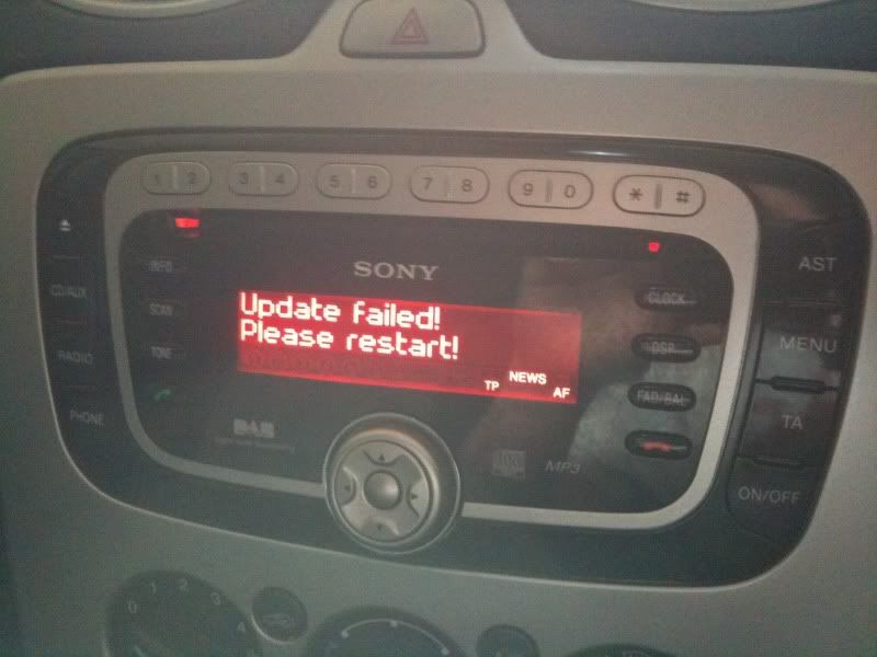

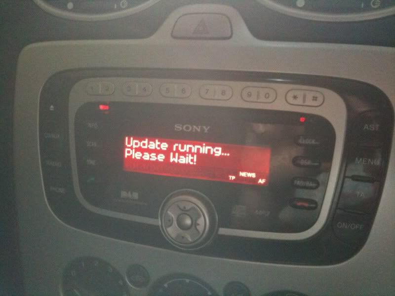

jay1981 Posted April 8, 2012 Share Posted April 8, 2012 :) Just done the update! :) First of all I followed the instructions on the website and surprise, surprise it didn't work. Just came up Update Failed in the radio display So I had a look through the FAQ on the update website, and it turns out that in some cases you have to delete all but two of the files from the USB stick. You have to make sure that the only two files on the USB stick are: 8M5T-14D511-AU.BVC 8M5T-14D511-AU.VBF All of the other files are for other languages, so not needed. Tried again: The update takes around 20 minutes, and is well worth doing. I can now stream music over bluetooth from my phone, couln't do that before, and no need to use the crappy Ford Y cable when connecting my iPod, the Apple cable now works! Quote Link to comment Share on other sites More sharing options...

jay1981 Posted April 8, 2012 Share Posted April 8, 2012 that's odd I looked in my usb stick and there is no files ending in " AT" (8M5T-14D511-AT) *you mention AU but in faq it states AT is english? Yeah, the FAQ seems to be wrong there are no files in the zip file that end in AT. There is 2 that end in AU, I deleted everything off the usb stick other than the AU files, and it worked. Quote Link to comment Share on other sites More sharing options...
