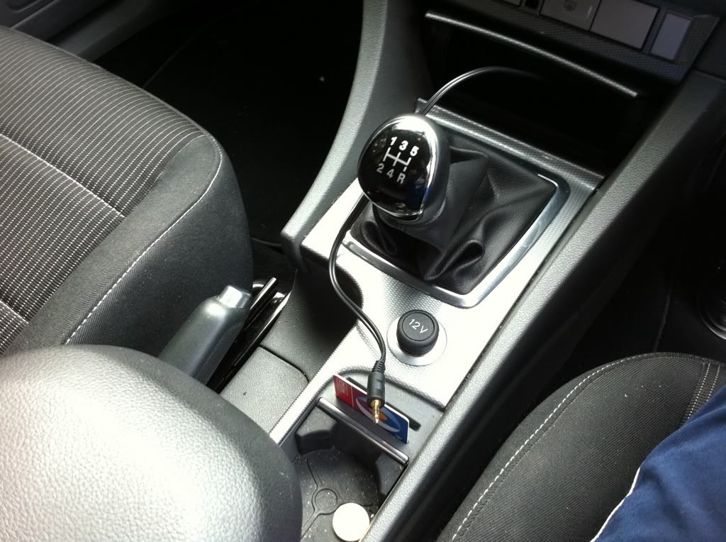

hey gregg i routed an aux lead from the glove box to come out where the ash tray would be picture below

Excellent, that was "plan b" was it easy enough to do, no obstructions? I watched a youtube link on how to remove stereo, looked simple enough. Where does the cable go to? Does it go back to the Aux port in the glovebox or did u link it to rear of the head unit?

hey gregg no i just plugged it into the aux in the glove box theres a hole at back so just made it a bit bigger then routed it down you have to take the side panel off on the passanger side of the centre console, how i did it was i felt behind where ash try would be and then used a drill bit to drill hole just making sure i didnt hit anything behind th console lot easyer then dissmantling the whole car few pics below
