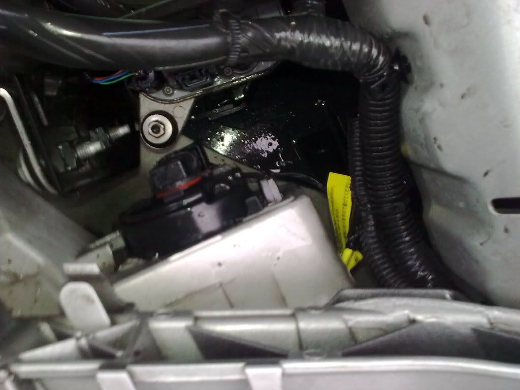

Hi mate,
if you remove the headlight as pree has advised then you dont need to remove the front off the foglight units,
because their is enough space with the headlight unit removed,
for you to reach down and twist then pull the H11 bulb from the fog light unit and replace the bulbs.
see how much space you have with the headlight removed. in the image below:
that thing with the red ring is the H11 bulb
