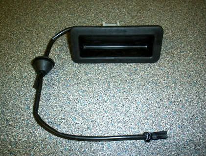

if its the same as the mk2.5 mate, which im guessing it will be in principle,
then you remove the inside cover of the boot door, to reveal access to six M6 nuts that are holding on the boot handle,
undo the six nuts and their are two clips left gripping the panel to the boot so squeese and push them out towards the panel.
thats it done mate.
do you have a replacment handle mechanism yet mate ?
i have one that is 6 months old from a mk2.5 selling it for £30 including postage if your interested.
