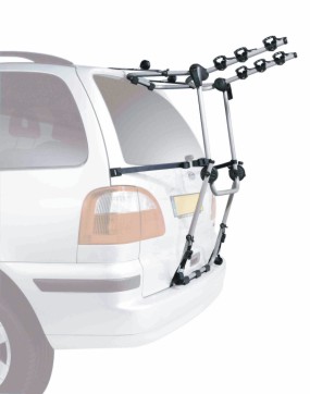

The worst case scenario will be that I have to buy a smaller tent for the family holiday this year. I have also been told that you cannot fit a rear bicycle carrier to the Econetic model, so bikes will remain on the roof and there is no option for a roof box to save the day.
Are you saying they've told you NOT to fit one of these?
I used one of these and think they're great. I've had 2 bikes sat on it and had no problems even on the motorway.
Could you not use one of those and install a roof box as well?
if all bikes don't fit on the back you could also look into one of these? bikes on back and roof and roof box. Just make sure you don't put to much weight in the car.

I carry 2 bikes on a rear strap type carrier with no problems, but had to opt for the 2008 Estate as the plastic spoilers on Hatchbacks and some later Estates were not strong enough to support that type of carrier, carrying bikes on the roof limits you to height barriers on some car parks; so you really need to a lot of checking as to what you want to use the car for and if it is suitable, before laying down the cash.
