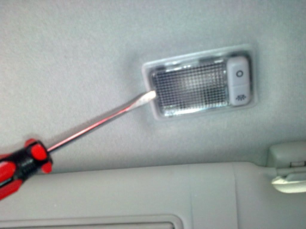

I'm trying to change the vanity mirror lights to leds buts I'm finding it a task to remove the covers to get to the bulb.
Checked the Manuel but it does not give much info.
Anyone managed it?
thanks

Hi Steve,
their is a slot on the end for you to prise it out with a small flat screw driver, preferably a precision screwdriver and not the size in the image below lol i didnt have a precision screwdriver for the purpose of the picture taken this evening.
see image:

Hi Lenny
thanks for the pic , will look again , did not know there was a groove :blink: :)

Posted 18 June 2012 - 11:52 AM
Done it , easy when you know how :) !
