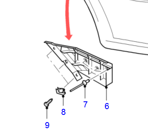

here is a ford diagrame of the rear bumper on a 2007 mondeo, it seems to be a similar fixture to the focus, you would need to remove the screws at the rear of the back wheel archs,
then peel back the flap to allow access to the inside of the panel, then their should be a bracket bolted through to the inside of their,
remove the nuts, on both sides,
then check for other bolts or rivets on the rear of the bumper underneath the car,
once all are removed then the bumper should lift off.
others may be able to give more advise mate, and if you need more detailed ford images just ask.

here is a closer look at the side panel inside the bumper,
it seems their is a bolt and a rivet, the bolt would go through the chassie and gripped the other side by the nut and then the rivet would hold the bumper to the bracket, and if you end up being without a rear bumper for a while, then have a look at my thread for holding the fog and reverse lights http://www.fordownersclub.com/forums/topic/32690-reduce-reuse-and-recycle/page__p__180691__hl__pringles__fromsearch__1#entry180691
looks like the rivets come through the the inside edge of the bumper,and made the original hole bigger,prob try a stainless bolt with a nylon washer on the end,thnx again lenny for the bigger diagram. :D
