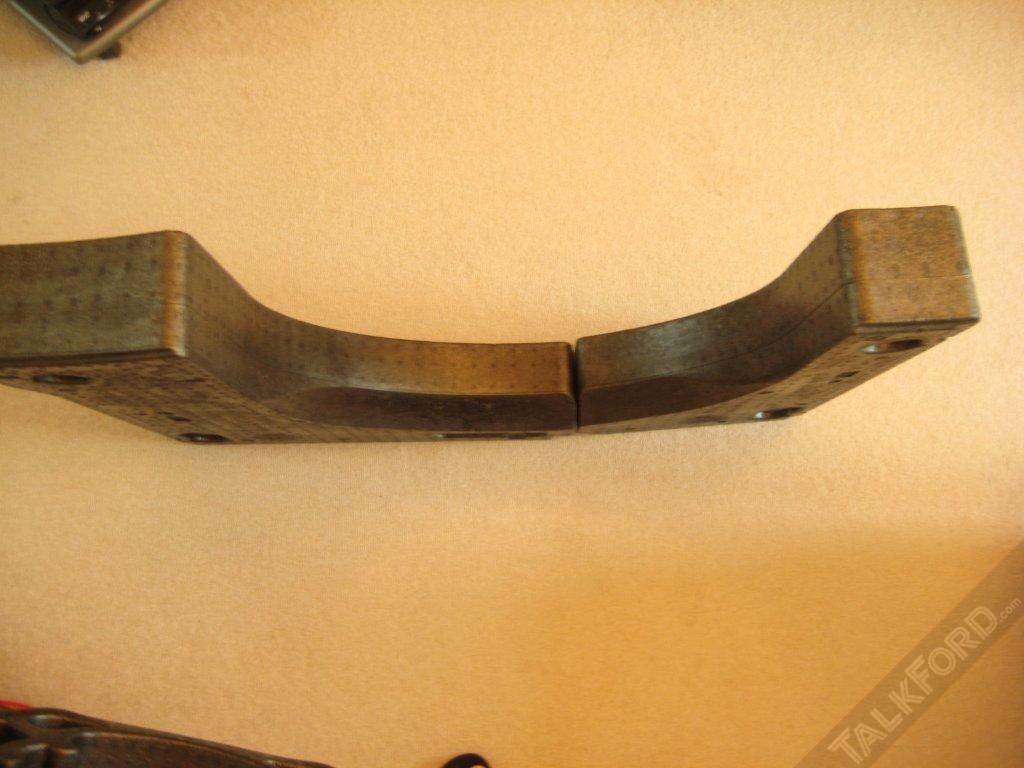

its 2 parts and made of polystyrene mate,
i got it for free along with the full sized spare as part of the deal from the dealers when i bought the car in 2010
ill check micro-cat for a part number.

nothing in Micro-Cat for it that i can see mate but here are some better images of of the kit.

Managed to get the finis codes for the boot lifter parts guys
For the left Section its Finis 1354075 Cost £42.20
For the right Section its Finis1344800 Cost £44.33

The Finis codes seem to have gone off the image lol
For the left Section its Finis 1354075 Costs £42.20 From Dealer
For the right Section its Finis1344800 Costs £44.33 From Dealer
