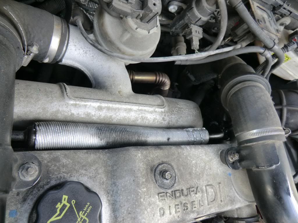

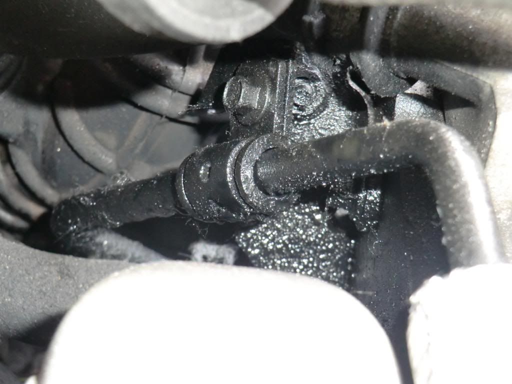

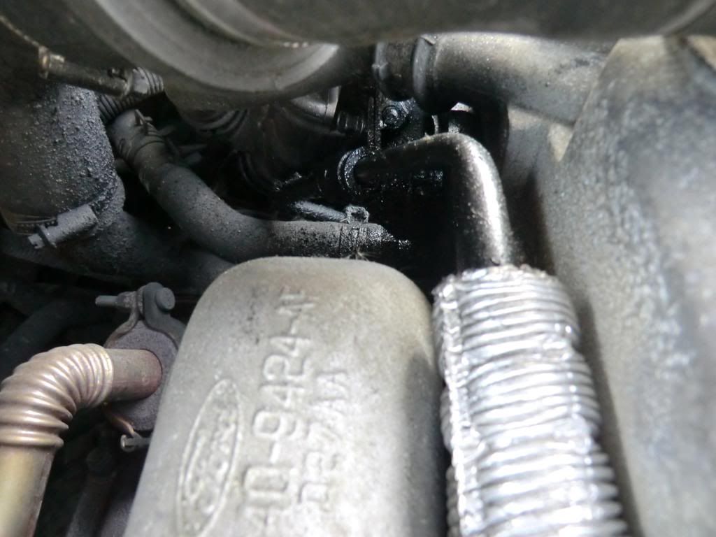

I got a focus 1.8 TDDI estate recently, and the oil light keeps flashing... seems to be worse when accellerating. Ive been told it may be a pressure switch, but after looking in the engine, i came across what looks like fresh oil... ive enclosed some pics of the oil patches, and the area where i noticed it.
Any ideas would be appreciated...

Is oil around that joint normal though?

Oil can seep all over the place. I would agree, do the pressure switch, and clean this area. Check again after a drive, and see if there is any oil there. Do you get oil drips on the floor whilst parked??
Give that joint a thorough clean, and then keep a close eye on it.
If fresh oil appears, you have the culprit.
If no fresh oil appears, then what you see now is just a slow accumulated build up over time.

Ok, got the oil pressure switch fitted today (pics added), however after 10 mins of driving the light came back on as normal.... What would be the next step? or what could it be? theres still no obvious sign of any actual leak, i dont see its a wire/lose connection since it only starts when the engine is warmed up, and linked to accelleration etc
sorry for the poor quality, they were taken on my phone
