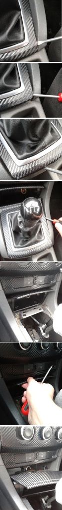

Posted 13 September 2012 - 04:09 PM
Well that's halfway done :)
Now to do the ashtray and gear surround, but I can't seem to figure out how to remove them.
Can anyone give me some pointers as to the easiest way to get them out?

Posted 13 September 2012 - 04:29 PM
Great first attempt at the wrapping there mate.
Like I'be said before, get a screwdriver under the corners of the gear stick surround and it just pops up.

Posted 13 September 2012 - 04:48 PM
Thanks, didn't take me too long but I got the hang of it pretty quickly.
I've removed the gear surround already,I meant the greyish trim surrounds that and the cup holders up to the centre arm rest. Or is that the same solution, screwdriver under the trim?
And what about that ashtray/storage thing? I can't seem to find any screws holding it in place?

Posted 13 September 2012 - 05:00 PM
The ashtray just clips into place under the demister panel and the gear surround on a 2.5 is glued to the upper console piece.
To remove the ashtray unit you'll need to remove the whole upper console piece.
On a mk2 you'd only need to unclip both parts of the gear surround.
I think for your model it's 4 screws at the rear and 2 bolts at the front and the footwell side panels need to come off too but they are one screw each under pop off covers.
Sorry it's more involved than on a mk2.

Posted 13 September 2012 - 05:13 PM
Didn't realize the mk2.5 was different to the mk2 lol I've just ran outside and done this
Waste of time lol

Posted 13 September 2012 - 05:52 PM
:D
Like I said the 2.5 has a different design centre console.
I believe the lower piece is glued to the panel so is more tricky to remove.
I think you can seperate it but will need to re glue it afterwards.

Posted 13 September 2012 - 06:33 PM
Well I finally got them out with a bit of brute force and ignorance.
Could be a bit tricky to wrap the gear stick surround considering I can't really separate the part I want to wrap from the rest of the trim...
