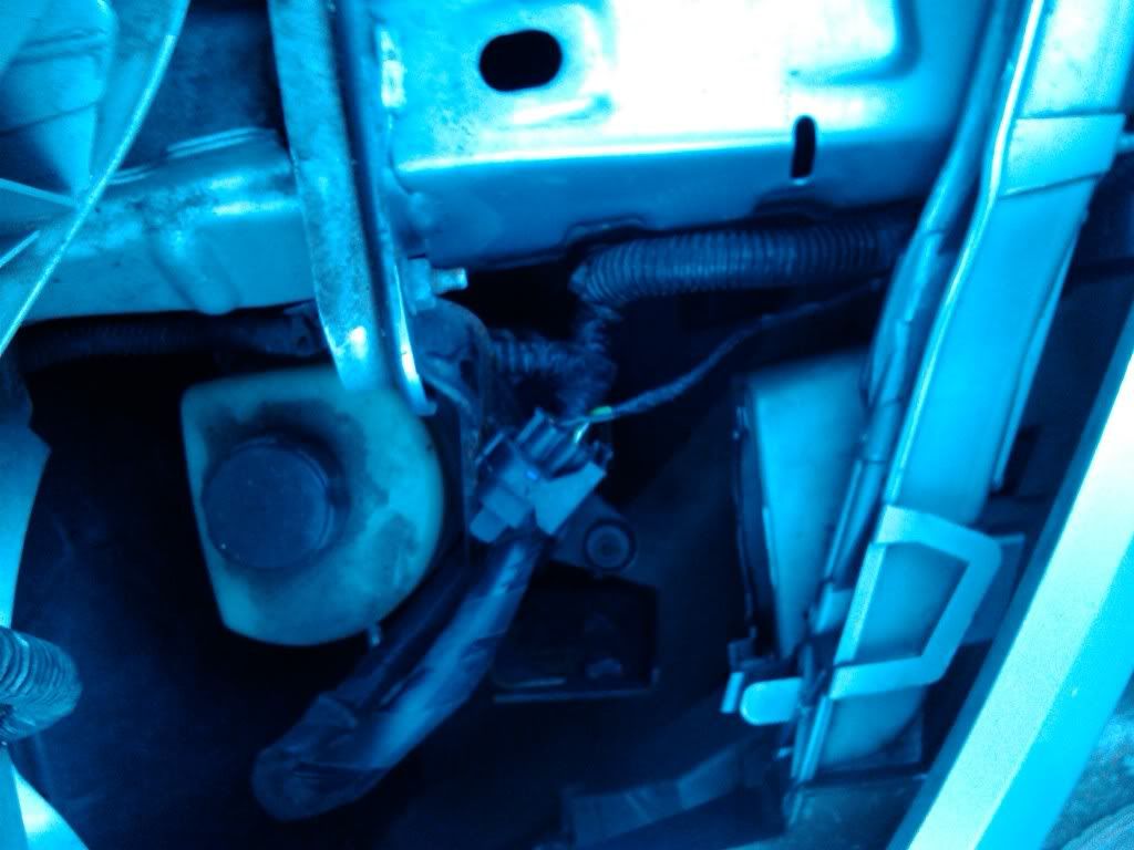

So I took the headlights off and there's a plug taped to bunch of wires on either side. Am I lucky? A black and white/green cable coming out of it.

I think those are the fog light plugs, will check tomorrow as I need to take my headlight off.

Yes mate, those are deffinately the fog light wires
