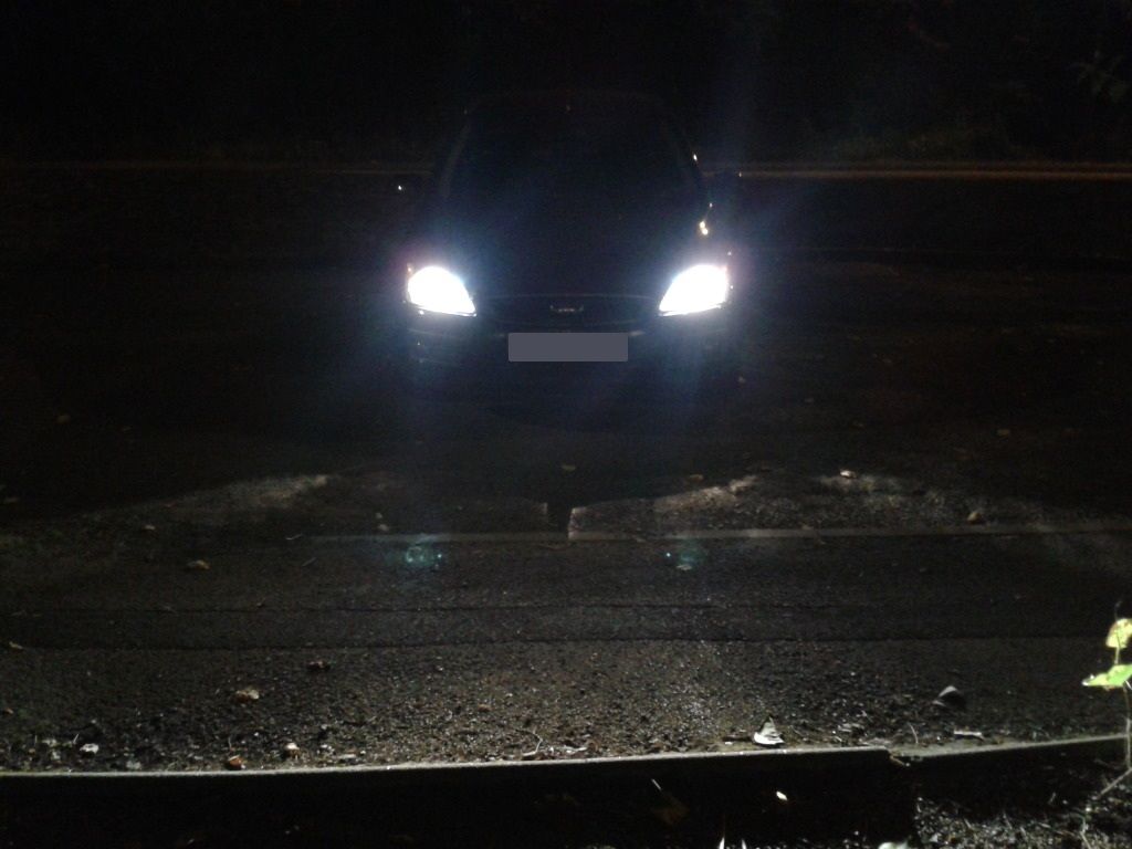

Here's what my osrams look like:
Ah ok I see. Well I have just spent a lot of money on this car already so I can't afford another grand or so... I will have a look at the osram cool blue intense, cos they seem to be quie popular. Do you know what type bulb will fit my focus?

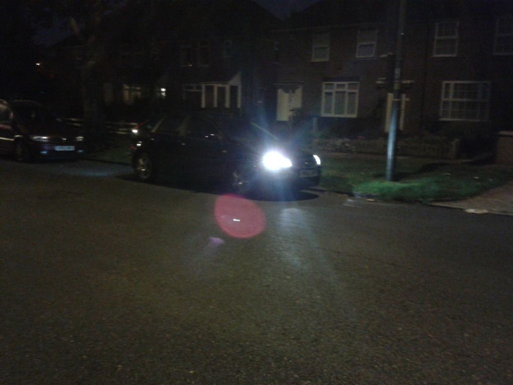

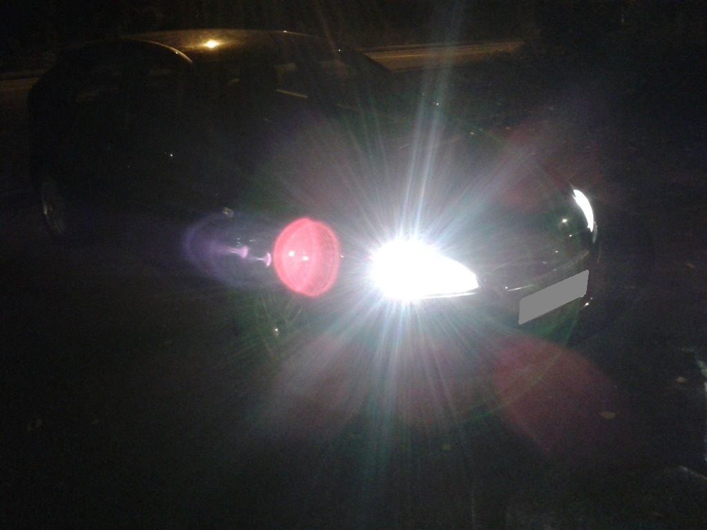

If you want to see how bright the Osram bulbs are, this is my video showing side, dipped and high beams.
