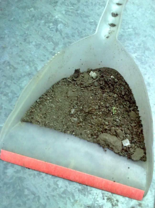

Once the screws are removed from under the black strips, don't be afraid to use force to remove them because they are well on their.
But don't prize them off just use your hands and work your way along them. Plenty of dirt trapped in their too
