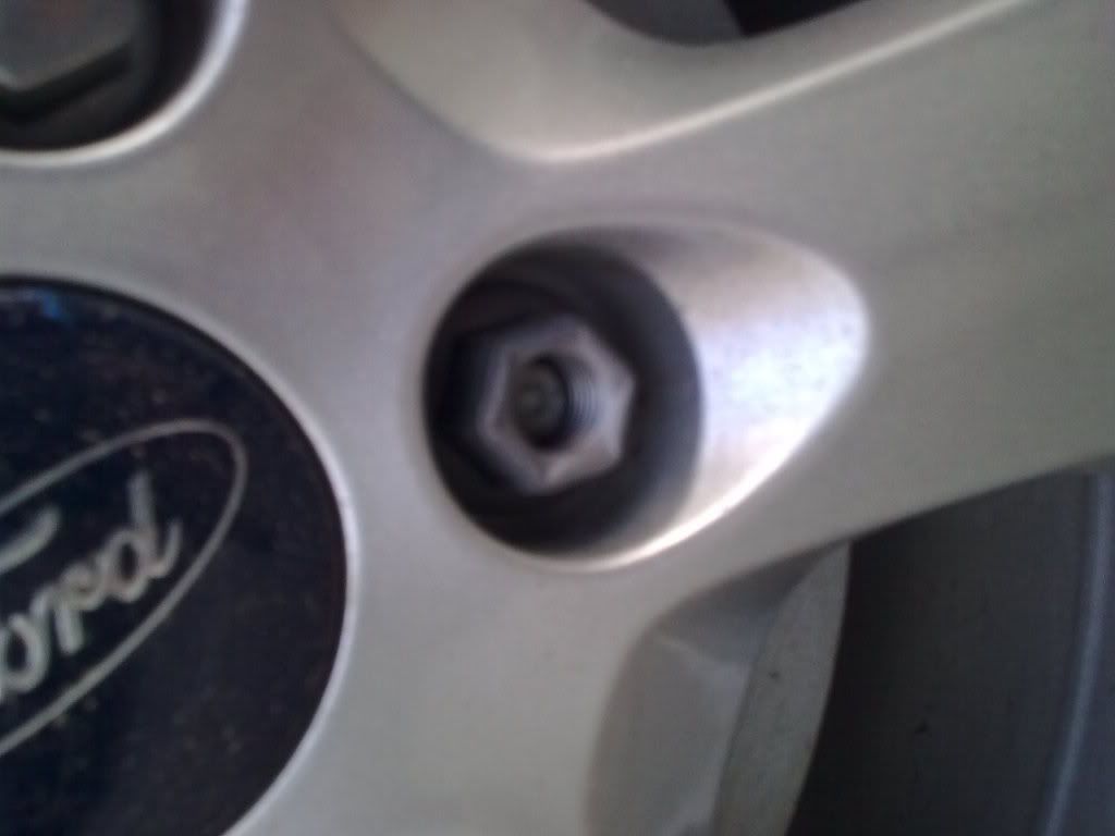

My Fiesta has come back from the garage and the wheel nut covers now seem loose. One you could pull off. Made me think these must be pieces of metal covers over the actual nut.
Do these just push on in a certain way? I thought it was all one nut, however now seem like it is a cover over the nut which is underneath it.
This is mk7 Fiesta with standard alloys fitted. Any help would be grateful. I can't see why the garage has removed these caps / covers in the first place.

They are very poor quality covers on the nut. They will split apart and fall off.

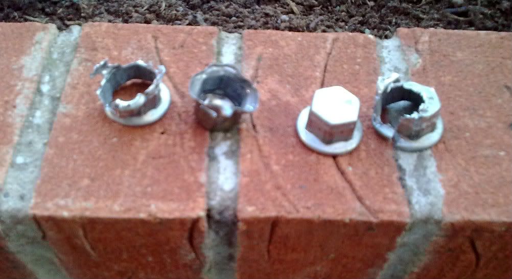

Ford standard nuts are extremly low quality,
Ive had my wheel brace socket put out of shape due to loose nut caps rotating on the nut when turning.
I had to remove the caps by tapping the centre and pulling them off, took alot of wasted time,
I plan to purchase some replacment ones but not from ford they are a disaster.
