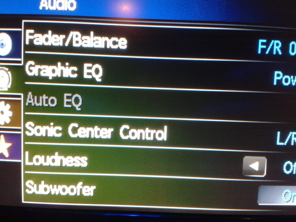

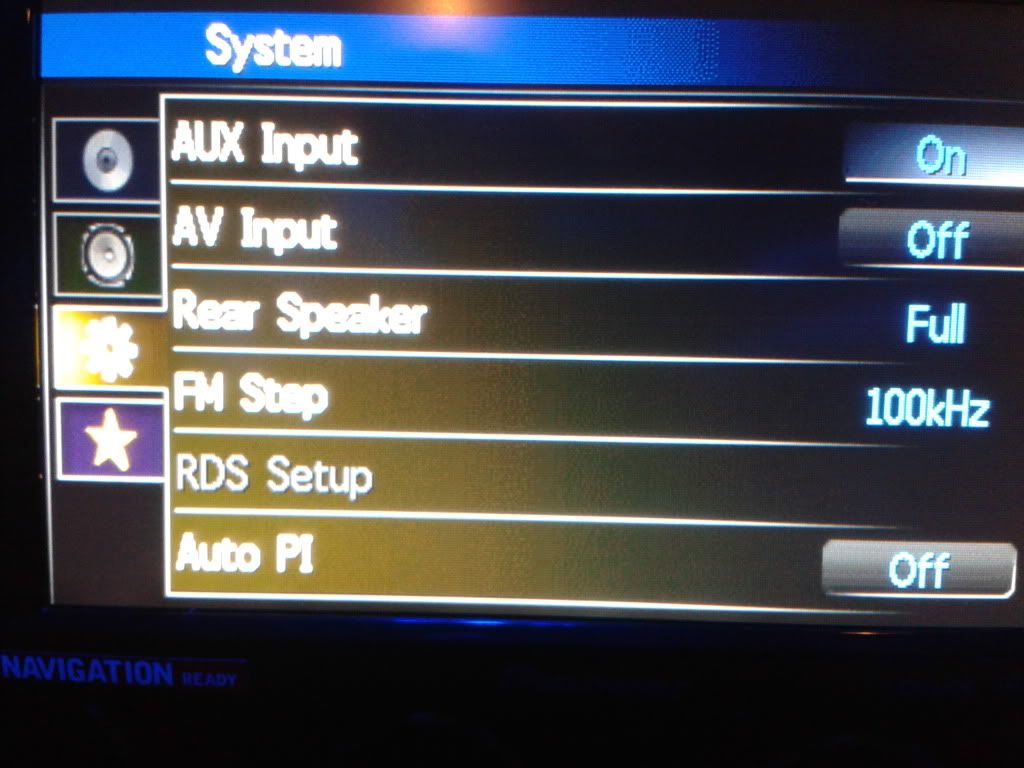

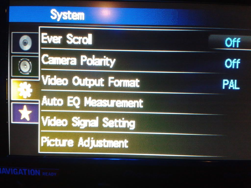

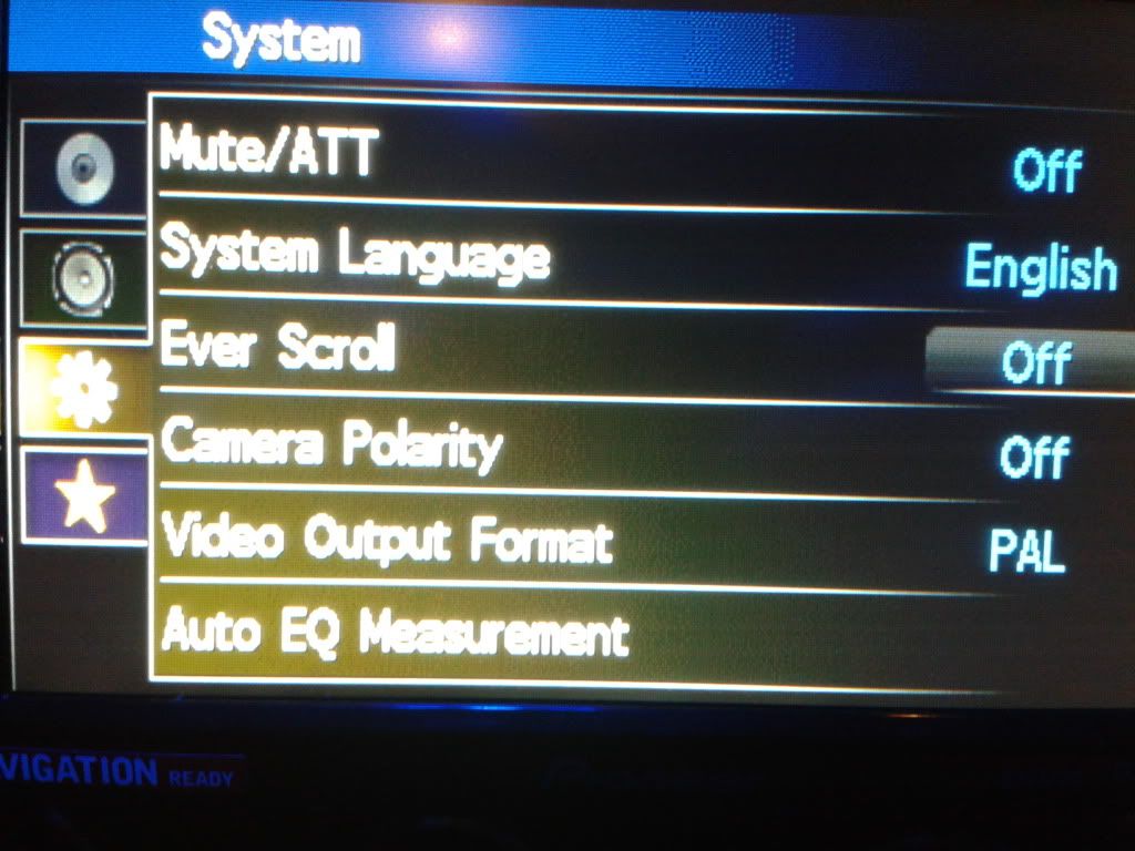

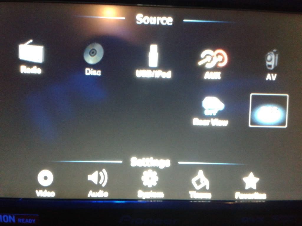

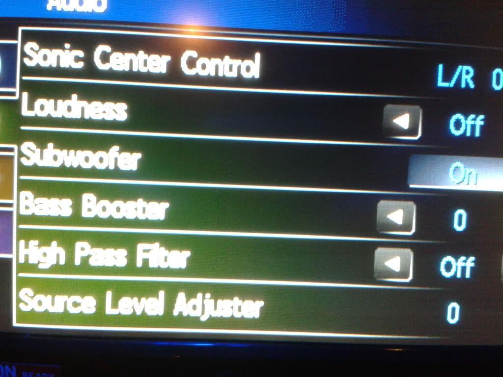

But I can't find anything in the settings to do with it. Surely there must be a sequence in the stereo somewhere to do it. I can't find the thing on google about it anywhere now.
Heres all the menu screens of the head unit
Can't find anything to do with the stalk controls
And as I mentioned about when the stalk control adaptor is plugged in, the stalk controls don't work but instead it messes up the volume controls on the stereo. This is what I mean:
Basically it won't let me turn the volume up, and If I try to it just turns it back down
