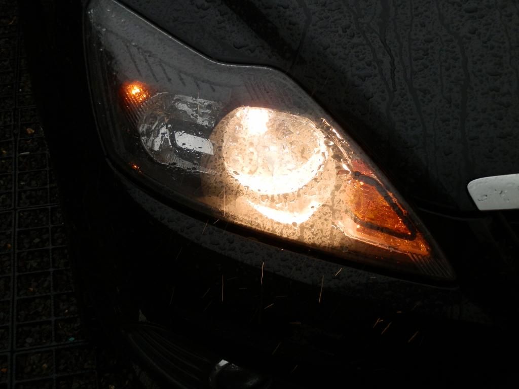

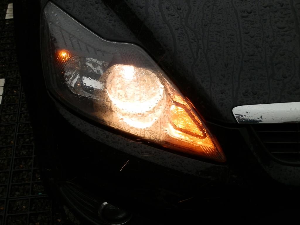

In my opinion we should adopt the american way of doing lights personally (with the exception of red tail indicators, people can't even be bothered to ensure their brake lights work these days!). Amber sidelights, (though in the US, they're not sidelights, they are parking lights, and you cannot legally drive with just those on!) these mark out a car/bike so much better, plus amber is the colour the eye responds to the fastest if what I read is correct, and "day running lights" should use the dipped beam at a reduced voltage. This reduces glare, but makes the car still visible to people.
I did notice the MK3 focus in the US has the same headlight design (bar the corner markers) with separate 501 amber bulbs rather than using the indicators.
Just an example of what I mean about indicators:
OFF:
ON:
