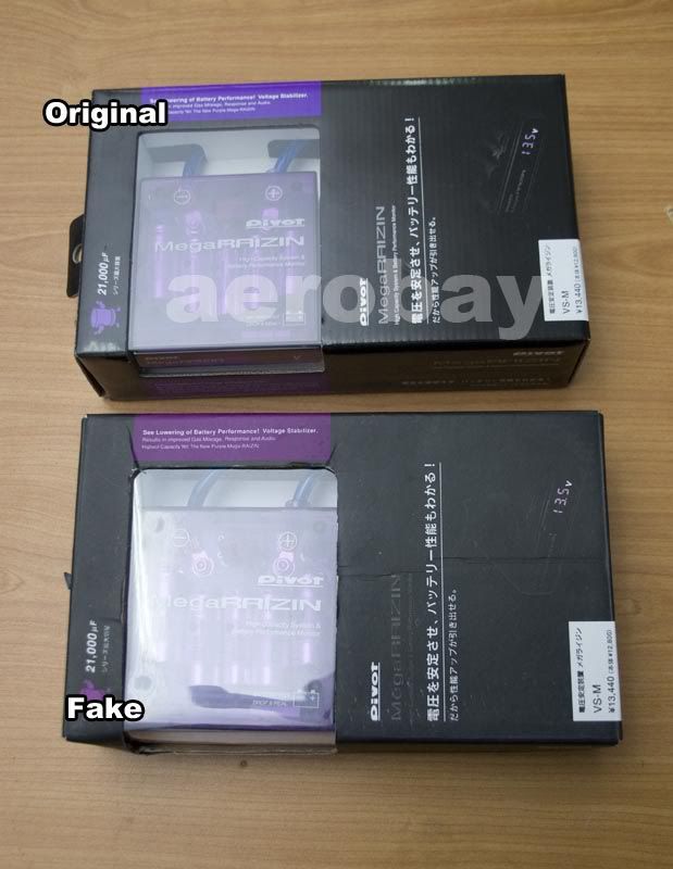

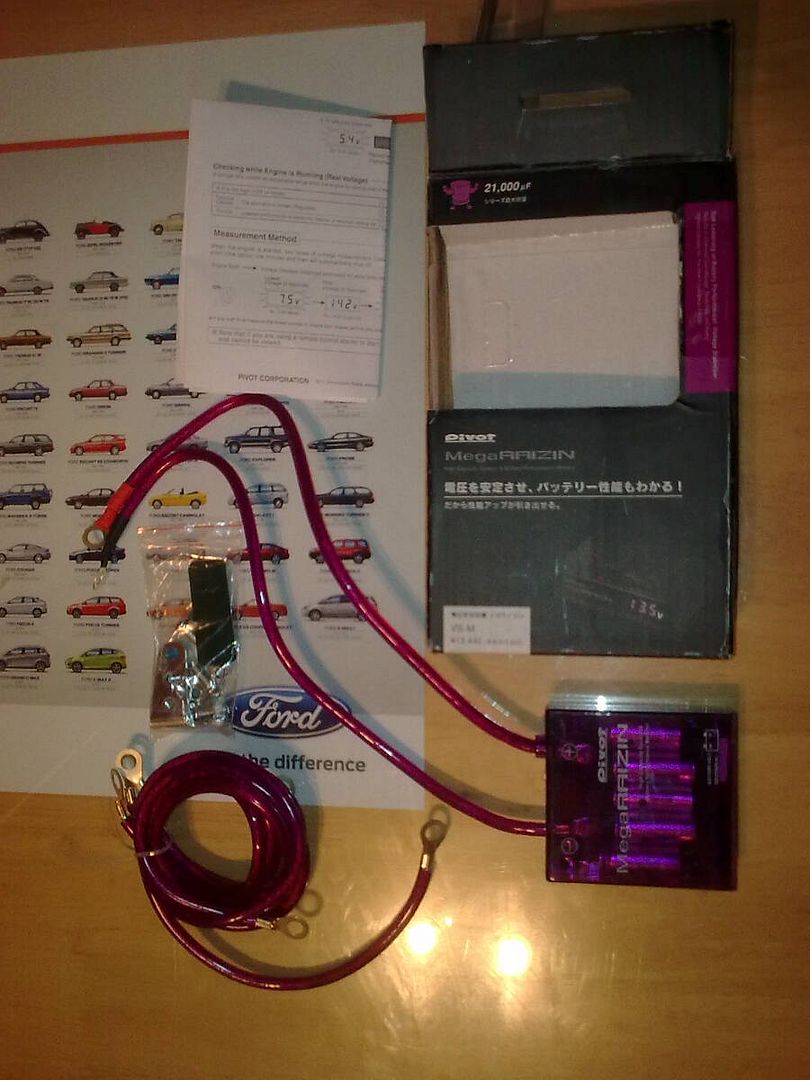

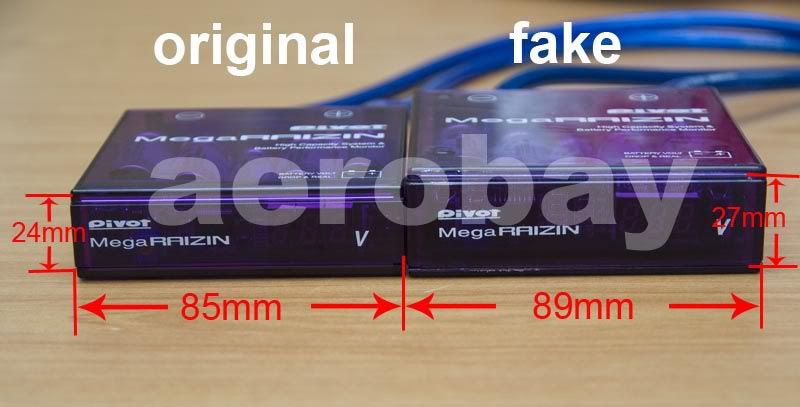

Ultimatlly their is one item on the market that can help the low current flow.
Its a Pivot Mega Razin Voltage Stabiliser.
Its basiclly a series of capaciters that aid battery performance and helping to provide constant 12v power regardless of demand.
Their are cheap replicas on 3bay which are complete crap but look identical to the genuine pivot system.
See the image below, its a replica that even has a photocopy of pivots instruction manual but genuine pivot is blue cable añd switches off when engine is off.
The replicas stay active 24/7 draining your battery, the complete opposite result of the genuine item.
For best reliability purchase from the pivot website.
Ive purchased from two different sellers on ebay thinking i was buying genuine but no their cheap replicas.
