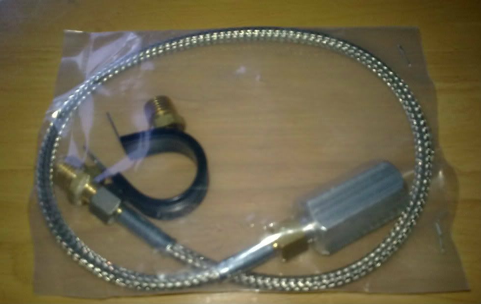

Ive got an oil pressure gauge fitted and ive purchased a braided hose with T piece take off
Which allows you to fit both stock and aftermarket sensors.
I first purchased the wrong sized braided take off which i now have no use for as i require for my 1.6TDCi DV6 engine is M16x1.5 sized one.
I will find out what size it is and it may match what you require.

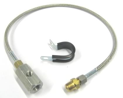

Hi guys thanks for the responses, ,really appreciate it! Lenny where did you purchase the braided hose and t-peice? ive found this on demon tweeks...
http://www.demon-twe...-remote-t-piece
Also i've rung Ford up and they don't even know what size thread the oil switch is! im assuming my fiesta TDCI would share some of the same qualities Lenny so if you could find out the thread type i would appreciate it,
Thanks again!
Hi mate,
Ford wouldn't need to know the spec of the parts due to the manufacture designated part number on each item specific to each model or engine size.
If your engine block is the same as my 1.6TDCi with the sensor location under the oil dip stick
Then you need this one.
http://www.ebay.co.u...984.m1423.l2649
Same as me, but I haven't purchased yet.
To be 100% sure that your sensor is M16 prior to purchasing the adaptor.
Go to your local DiY store and purchase an M16 nut,
Then try screw the oil pressure sensor in to it.
If it fits then the M16 adaptor is the one for you.
I've logged on to micksgarage.ie and typed in my engine and car model.
Then selected oil pressure sensor.
They then offer to sell the sensor aswell as showing the size and says its M16 on the 1.6TDCi engine.
